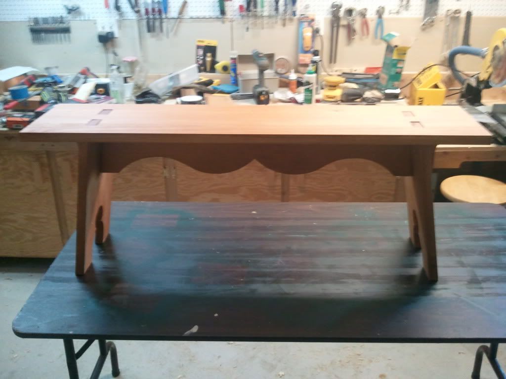

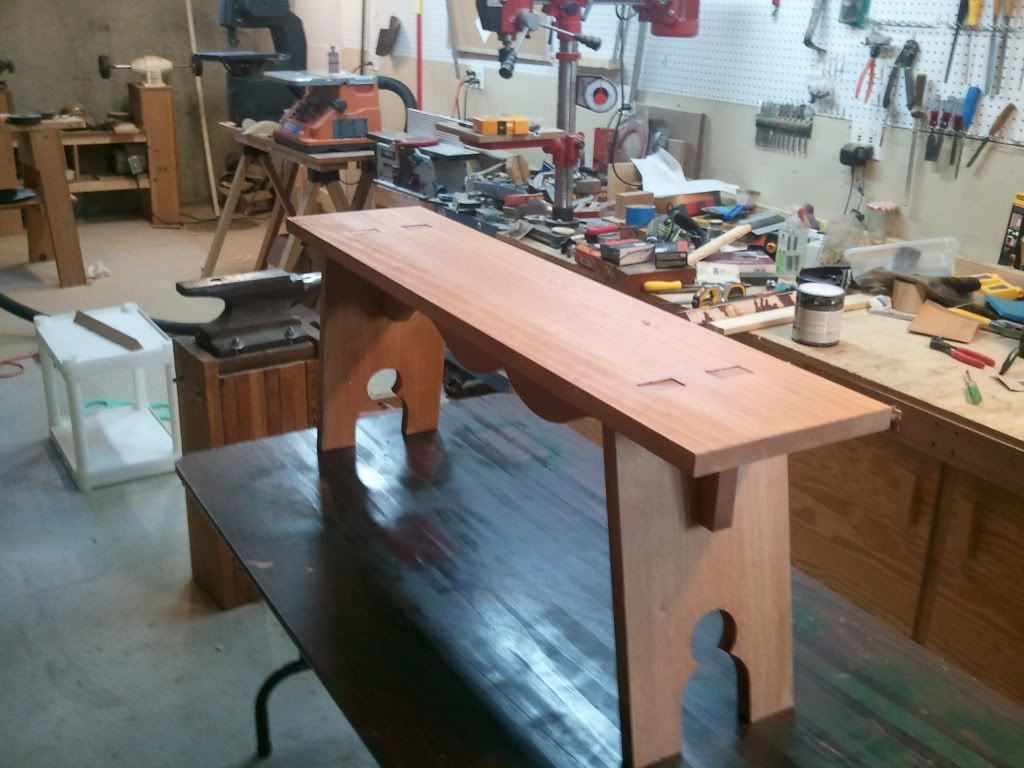

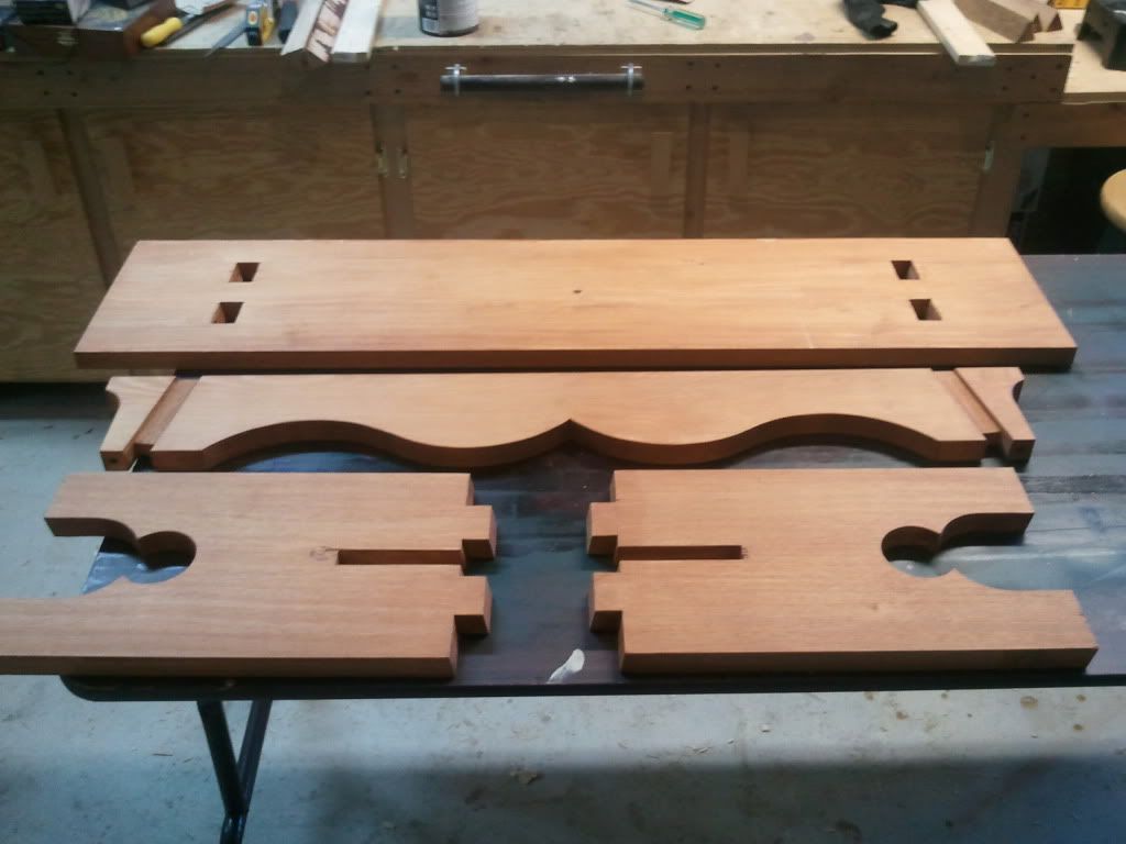

Rather than convert that to a mortise and tennon, how about the mortise and tennon versions on this page? 2 sides, a back, a seat and a vertical cross-bar under the seat to prevent sagging. You could probably knock them out of 2x12 fairly cheaply but I've had very good luck with stair-treads as well. They are 1" nominal thickness instead of 3/4", come in convenient lengths and the cheap ones are actually laminated small pieces with a veneer layer to make them look solid. Quite durable, 66% the weight of 2-by construction and don't look like 2-by construction.
http://www.pinterest.com/bennynordmark/ ... d-housing/
This bench was made from 2 stair treads and a piece of 5/4 pine for the center rail.
http://i161.photobucket.com/albums/t239 ... 183137.jpg
http://i161.photobucket.com/albums/t239 ... 183122.jpg
http://i161.photobucket.com/albums/t239 ... 182942.jpg
