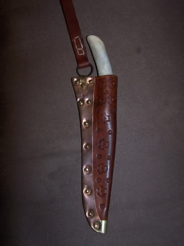

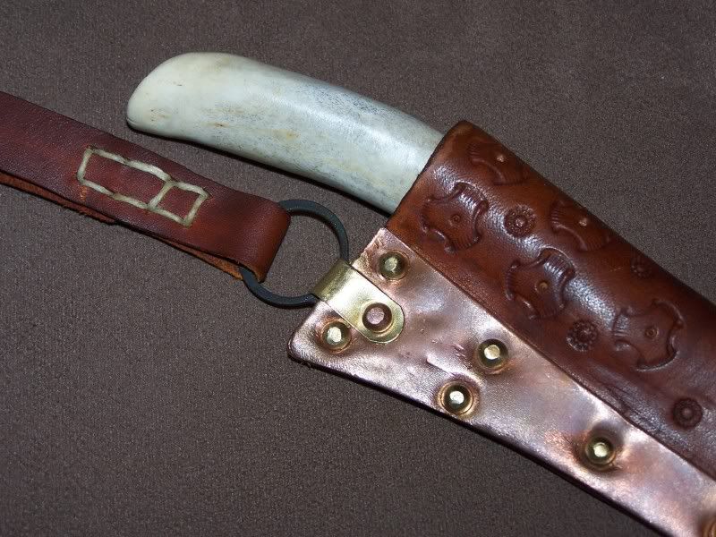

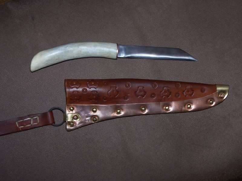

I just finished 2 knives that I made from files just doing stock removal. Both have copper trim with brass rivets. I used contrasting brass with copper rivets where I hold the belt loop on.
The handle on this one is red deer. The handle has been buffed with bees was.
The blade is about 4.5" long.

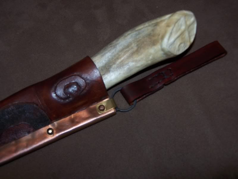

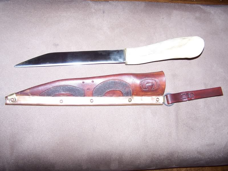

This one has a 7" blade.

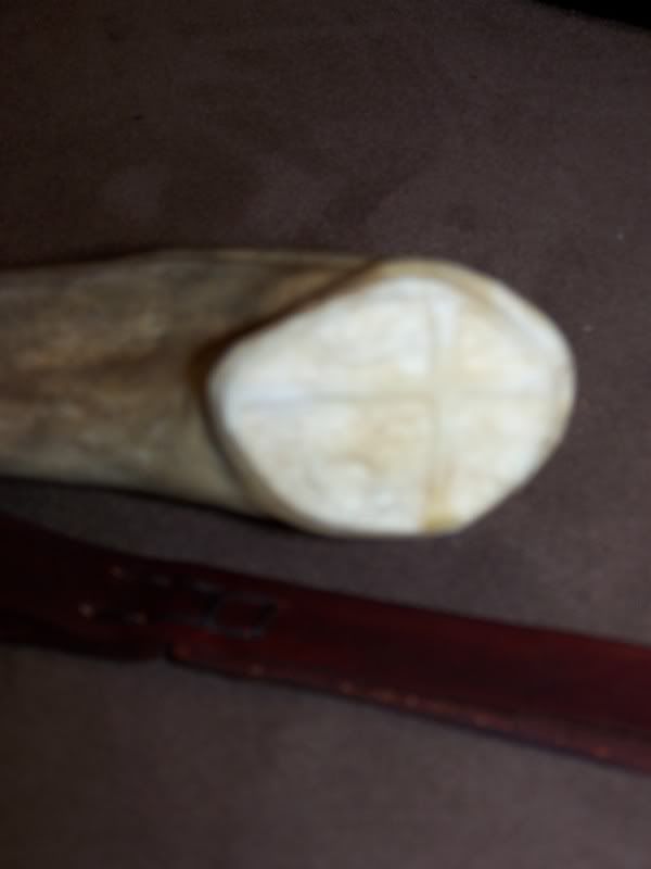

I tried a little bit of carving on this one. It will be a gift for my knight this weekend at our Kingdom's Fifth Year event. His device bears a cross and crescent.
Not the greatest picture but you get the idea.

On the second sheath how do you get the leather to stretch in to a curve so it fits smoothly around the angled point of the seax?
I'm guessint that you somehow have to stretch it? Can you give me a bit of a guide?

Wulfgar wrote:On the second sheath how do you get the leather to stretch in to a curve so it fits smoothly around the angled point of the seax?
Yup I stretch it. I wet the leather and form it over the knife. At this point I still have extra leather at the tip.
I take 2 small wooden planks and clamp them over the blade. Then I pull the end of the leather down while it is in the clamps. That make sense?
After it dries I go back and trim it, cutting off the excess.

Wulfgar, I don't have progress pics, sorry. I start with a rectangular shape and wet it, then fold it over the blade. I sandwich the blade with 2 wooden slats. So it is wood, leather, blade, leather, wood.
I put clamps on it. At the tip of the blade, I take the excess leather and pull it down so it takes the shape of the point. I usually let it dry over night.
