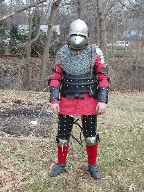

Dont really post a lot on here but I'm often connected to this forum by the hip so what the hell here we go. This is my first attempt at a Heavy SCA kit, made it over the course of 2 months from the skin out (with the exception of the shoes and helmet, everything else I sewed or fabricated) for just turning 21 I am fairly proud of it. Since the photo I trimmed down the aventail a bit, made a bar grill for practices and have some greaves in the works as we speak! All in all there is a lot with it I dont like such as the helmet, which I'll probably be trying to make a new one myself after clearing out my order ques (In 6 months I have gotten 3 friends on the field armoured up...if I cut another splint I'll probably have an anneurism ).
Well without further ado here's my attempt at a 1351 kit, maybe one day I'll fight in the 30!
I'd love any helpful criticism on it

Pretty damn good for a first kit to be honest. Three things stand out to me.
Stand up straight!
Your vambraces are a little fat at the bottom. Could just be a strapping issue or too much material down there but more taper will give you a better fit. More cone, less tube shaped if that makes sense.

Posts: 176
Joined: Sat Nov 07, 2009 1:52 am
Location: Buffalo, NY
Re: 2012...Show us your kits
Post by johnameyer »
Thanks Isabella!
never had someone call out a kit for bad posture, but it did make me giggle.
the vambraces are a little funky, I wanted them to overlap but the leather itself is 12oz and I think way overkill for the intended purpose, also the rerebraces being too short drives me insane (should just busted out the tape measure and not eye balled it). Though this is sort of my "get on the field and fighting kit". right now I am working on an alwhyte harness, got some good practice in making this for a friend.
the plan right now is just get fighting and get more harness time in (while also not looking like a dumpy trash can) and slowly phase this kit out into a blackened hanress circa 1400 Italy.

If you want to make tweaks you could probably take the straps off and trim the leather a bit for a better fit. Also, if you curve the top and bottom it will give you a better shape around the wrists. The first vambraces I bought were too long and not tapered enough and generally just did not work. I made 2 pairs myself and some of the best advice I got was here on the Archive from someone with those same points.
You already look better than probably 50% of SCA fighters in general.

Like the kit Johnameyer. A great starting kit, especially as you made it all yourself. Isabella's posture comment holds water I think. Standing confidently will make a good kit stand out more, as it fulfills the image of a heroic knight that little bit more.
A quick note on the cuirass you've made (which looks cool): All cuirasses should overlap front to back on both sides. Otherwise, lance strikes will catch on the backplate and completely destroy it.
