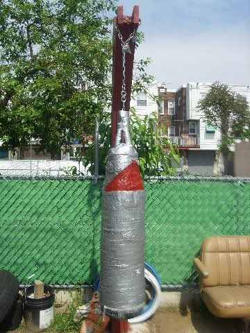

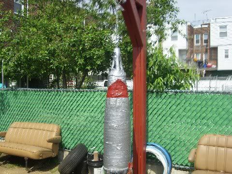

I dug into the ground about 3 or so and planted this monstrosity. My neighbors were definitely curious what the tattooed white boy was going to do with something that looks like the gallows.. :shock: :lol:
If I had a tree I would have dropped a chain around a good firm branch and hung it from there. With trees being scarce aside from smaller ones I made something that worked for me. My knight swears by the tree pell. He said he trained with one and would get it worked up and spinning quite fast. My squire brother has a tree pell now and I am envious of his setup.
If you are to hang a bag for a pell I suggest a bigger bag. This particular bag is set up that all but the chains are equal to my legal target area. The upper section of the bag I've taped with red to help me work on my targeting of my squire brothers and Knight's shield shape top.
