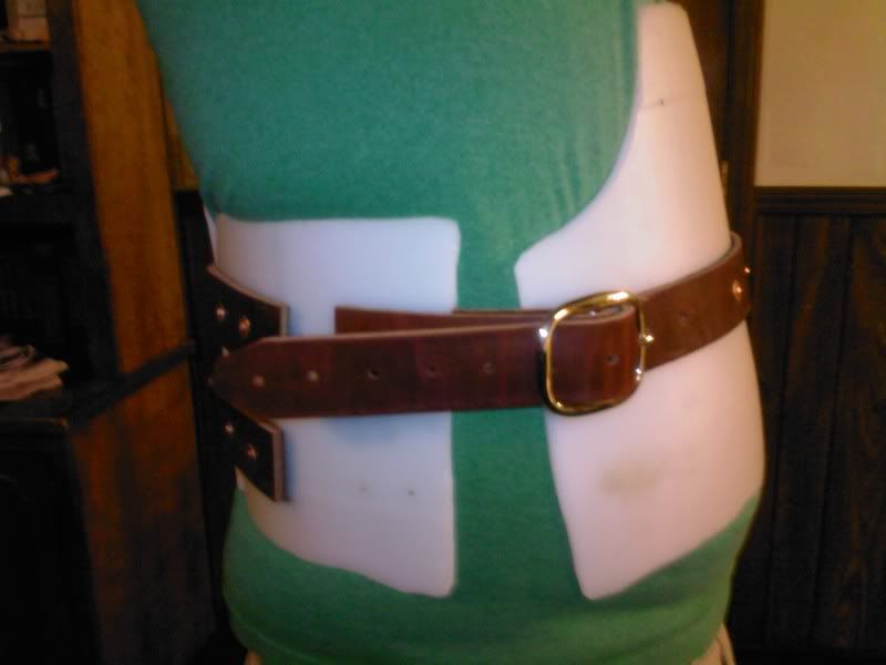

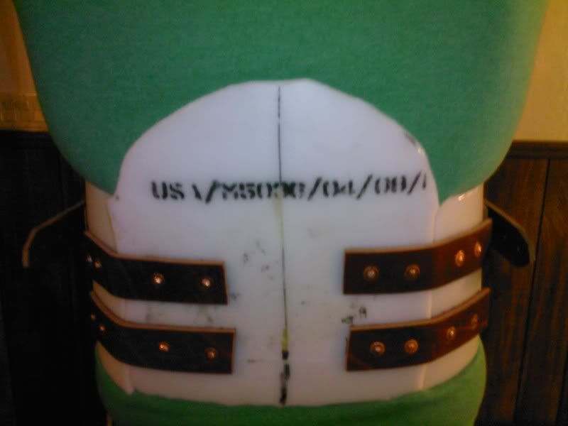

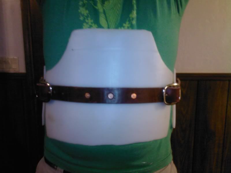

Just finished phase 1 of my hidden armor project. Quick, ugly, and cheap (insert crass joke here).
Needs a second strap on the bottom, and it will be placed over a padded vest/gambeson, then under my tunic. It looks a bit snug, but I plan on losing some weight (on the doctors orders) so if all works out as planned, it'll fit fairly well at that point.
