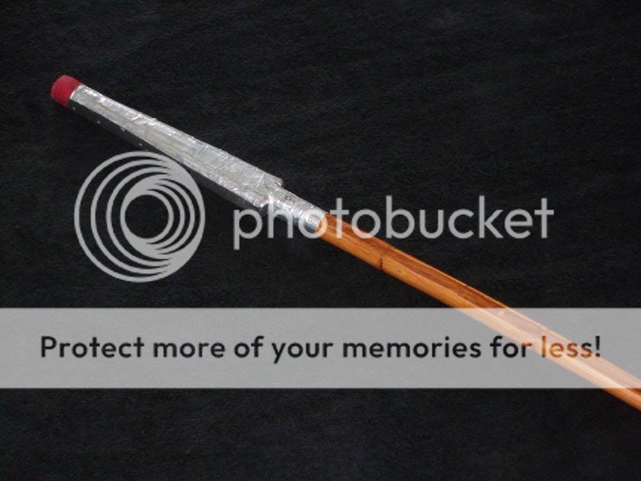

I just made this pole, in the "Sir Corby" fashion...
There's a second piece of rattan that forms the "blade" edge on this one. It's a bit tapered at the top (towards the thrusting tip) and fits into a notch on the haft. The notch is about 3/4" deep at the deepest point, and tapers at the same angle as the blade piece. There's also a small "chock" of rattan at the bottom of the blade piece. After that, everything is taped to hell and back with strapping tape, then covered with gorilla tape.
Coming from using padded head polearms for quite a few years, I had to dial way back to make sure I wasn't really clobbering folks at fighter practice. No biggie, I tend to do that every time I make a new polearm until I get the feel of that stick.
I really dislike the 7 foot stick with tape on it "polearms" that I see at war, but I'm willing to make a compromise. If we can just get rid of the ones that are excessively whippy, and the ones that have no real edge (I've seen them with spiral taping, or just no edge marked at all), I'll live with the rest of them.

my only argument is that i dont equate padded polearm with "real" looking.
Sometimes yes, sometimes, no.
Mine looks, to me, kinda like a real weapon with no padding. Ive thought about adding shaped foam to get an even better profile, but then it runs into the 1/2 into the visor rule. Though, I would LOVE to put a "sharp" looking edge and a really squishy pointy tip on it.
http://i458.photobucket.com/albums/qq30 ... 730831.jpg
A lot of the split rattan (while thankfully they developed it because it allows us to do other things) dont look real to me cause they often have holes in them. I just cant figure out what weapon they approximate.
I fought with a solid stick for awhile... Mostly because i was lazy, i never even thought of it as a game of the rules. I did use it to build my new one above though. Anymore though, i dont think i would do it unless i have a very wierd set of circumstances.
Cheers!

Dilian, i agree completely. Ive been hit with padded poles that were plenty stiff, others were like a pillow. Both looked like good weapons. The big problem i think is people genuinely do have a hard time judging the all pad polearms without clackers. They are looking for that "pop" sensation, which they will get with a thrust since its over such a small area. But in a similar vein ive seen people get pushed to the ground with a thrust and not take it because it didnt "hit hard enough" Doesnt happen as often but a very similar issue.
Still back to the padded poles, i think another part of it is people just dont see them that often. They are so used to taking shots from broad, bastard and great swords, that they arent programmed to take padded pole shots.
As an aside, here is a thought....
Since force = m*a, could they just say that anything with a balance point more than X % forward of the midpoint of the weapon shall require a padding on the striking surfaces? Too heavy of a head, and you need padding, light enough and you are ok.
Lets say 10% forward of the midline is the rule...
7.5 foot polearm = 90", so 10% would be 9". The one i posted above is 4 inches forward of midline. No padding needed
Lets say a 70 inch hammer balances 11 inches forward of the midline.
46 inches is 64.8% of the total length, 15% forward of midline. Then it gets padded.
Counterweights on polearms would have to become a no no since you could game this rule pretty easily.
Thoughts?
