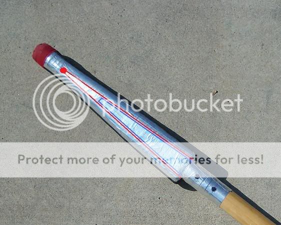

Got tired of the stick with a q-tip called a glaive (see my post in the spring kits) so i tried something new today. Sorry for the crappy pic, best i could get this evening; better tomorrow.
[img]http://i458.photobucket.com/albums/qq305/machkyplr/glaive1.jpg[/img]
Split rattan construction, some flexible epoxy, tape and presto! A new ass kicking device.
Picture doesnt give a good idea on size, but its 7 foot overall with 16 inch head. It balances very well and should be fun to fight with. Im just hoping the head will stay secure, though only time will tell.
Comments are appreciated!
Cheers!
Posted: Tue May 19, 2009 6:05 am
by Valstarr Hawkwind
sweet looking.
Val
Posted: Tue May 19, 2009 6:28 am
by Glaukos the Athenian
Milan! That is awesome. :shock:
I wants one preciousss.... :twisted:
Please post, pm or email me construction details....
How does it balance?
Thanks!!!
Glaukos[/u]

Posted: Tue May 19, 2009 11:59 am
by Milan H
Well i thought about doing the photo essay thing but i was going too fast so youll have to bear with me. :) Warning.... Long post since i didnt take pictures and have to describe this. Also be warned, i havent tested this in combat, so it may just suffer a glorious untimely death... We will see!
Get a stick of rattan about as long as you want the head to be.
Drill a 3/8s hole through the rattan. This acts as a stress relief and will help stop the splitting later on.
Then on the thrusting side of the hole (short side) i wrapped the rattan securely with strapping tape. This too is to keep the rattan from splitting further than the hole.
Next i eyeballed it, and split the long side of the stick with a hammer and chisel. Rattan breaks mostly straight down the grain, so you should be ok splitting it on this short of a length. I did stick the drill bit back into the hole so i had a better reference. I missed a little, but the split did hit the hole.
I then removed about 1/4 inch of material from inside of the split with a chisel and a putty knife. This allowed me to straighten the split up so it was square to the hole i drilled. I smoothed it as best i could with the chisel (you will need a vise to hold the stick, and then jam a piece of wood in the split to hold it open so you can work)
After that, i used a torch to burn the brooming and fuzz out of the split. I wanted a strong bonding surface for the glue. Dont scorch it, just get the fuzz out.
After that with a chisel, rasp and plane, i tapered the end of my rattan stave. I left the end just under 1/2 inch wide, and it tapers up to the diameter of the rattan. This you want to be relatively flat as well. You want this to be fairly long so you can get the rattan to bend down and make contact plus give ample gluing surface. I just forced the rattan head open and laid it on top, marked where i thought it should go and started tapering. Dry test your fit. When satisfied, get several clamps and practice clamping it. The round rattan can be hard to clamp. It shouldnt be difficult to push the rattan down to match up though. If it is, you may need to adjust your taper.
Now get some flexible epoxy. Gorilla glue epoxy is what i used. Its a 5 minute epoxy, so get all your materials, clamps, and mixing station close to you. Mix probably twice as much as their little tray on the package will hold. Mix in something you can throw away. Slather the glue all over the tapered piece of rattan, and quickly stick the head on and clamp. You only want glue on the cut surfaces. Clamp it and let it set for an hour or so. Expect epoxy drips all over the place... Do this over something you dont care about, in clothes you dont care about, with shoes on you dont care about :)
I removed one clamp, then wrapped the head with a strapping tape to keep it down, Do that for each clamp. (it took four clamps for me to get it clamped securely) I suppose the glue ought to hold, but i was in a hurry and didnt wait as long as i could of. Realistically, i should have waited 24 hours to let the epoxy fully cure.
Clean up the excess epoxy drips from the rattan with your chisel.
Now i started taping with strapping tape. Lots of Xs of tape that hold the head down to the stave. Then spiral wrap the whole thing nice and tight. Do a smooth neat job cause it will be stronger that way.
I didnt like the profile of my head, the point was too long, so i trimmed off a few inches. You may or may not have to do this, but if you do, be careful to leave enough material in front of the hole that it will stay together. I figure 1.5 - 2 inches.
Put on a thrusting tip, cover in your favorite duct and marking tape (i use hockey tape for my tips and cutting edges) and you are done.
Took me about 2 hours including the trip to home depot to do it.
Glaukos. It balances at 40 inches from the point, with an overall length of 84 inches....So 4 inches forward from the middle. :) The butt spike helps with this im sure.
I wont be staining the haft now because my gauntlets tear the crap out of it. My rattan stave looks like my dog used it as a chew toy, but i will admit im tempted. If the head holds up to combat i may stain it. We will see :)
Hope thats helpful guys!
Cheers!

Posted: Tue May 19, 2009 4:40 pm
Also, I think that once you split the "blade", If you stick in there (temporarily) a little piece of rattan and then steam the whole thing, it will remove the "tension" that would lead to splitting the point, since instead of trying to continue splitting, the side of the blade would be "stabilized" in that bent position by the steaming.
I did that with the blade of my Kopis and the results were quite spectacular in reducing the tension of the rattan splints...
Glaukos

Posted: Tue May 19, 2009 5:54 pm
by Milan H
I like the idea of steaming the head. You could get some REALLY cool shapes of the head for that. Even a leaf blade if you were patient enough...
The cool thing about this is that you get a real looking head (relatively) without adding a ton of weight. Because the balance is so close to the center, it tells me that i really didnt add much weight to the point. Striking characteristics should be the same as a typical sca Glaive. Removing the material in the middle of the head causes this i think.
Glaukos, I hope this works out for ya, your PM got me thinking about it so i think we owe each other a "beverage of choice!"
Cheers!
Posted: Tue May 19, 2009 6:35 pm
Milan,
I was thinking about this right now as I was driving back from my daughter's Karate class.
This is a thrusting weapon. The main thrust is borne by the sloping surfaces of the split head. Every thrust is basically trying to continue splitting the head all the way up. It will eventually happen.
Now all the tape you put there probably means that when it happens it will not be a catastrophic failure (i.e. the shaft free to enter someone's grille at the worst time) but when it does the weapon will become useless until repaired. This is because the thrust is not directly supported by the shaft but though the "partially split" head. Once split the head will go limp.
I think that a safer and more durable way might be to leave the tip of the rattan stick itself to bear the thrusting tip.
Then split the rattan head sides completely.
About 2 inches below the thrusting tip's end (enough to allow full compression) , shave the shaft to flatten it a little on each side and attach the front halves of the head. Shave the top rounded sides of the head as needed.
Now slice a one inch thick slice of rattan. Split it in two. Place each half between the back ends of the "head" and the shaft. This will make the head of the spear triangular by spacing the blade from the shaft.
Flatten whatever needs to be flat in the shaft and pieces with a rasp to achieve a good flat to flat contact.
Glue as you did and tape the crap out of the whole thing.
Now you have the exact same weapon, but the thrust goes straight into the shaft of the spear, with no stress or possible catastrophic failure. And your head can still catch a shield rim with the back of the spear head.
(Am I making sense or just babbling?)
I need to meet Lucas to get the rattan stick I need to build this.
Though I may go crazy and build a little leaf blade like in the Hoplite Dory spear.
Thanks!!!

Posted: Tue May 19, 2009 7:17 pm
by Milan H
Interesting and i agree with your thoughts and solution.
I feel half tempted to go and see if i can destroy it on the big rock in my yard now.
On the other side, I tend to do a lot of cuts with my pole arms. I may not be visualizing your idea well, but I think more support would be needed. How about something like this?
Gives more beef for striking, better support for thrusting, weakens the rattan a bit but its not likely to be an issue if it were to break since its behind the head and would be taped anyway.
Thoughts?
Posted: Tue May 19, 2009 7:40 pm
Milan H wrote:Interesting and i agree with your thoughts and solution.
Thoughts?
That is an excellent solution, though a laborious one. Also. will it not weaken the tip of the shaft where you put the relief cuts?
Besides this, it sounds even sturdier than my idea, since the edges of the head now rest on the cuts you made. Clever....
Now take each side of the blade, remove the "barb" in the back, steam it into a curve and place the little piece of 1 inch (here 1/2 might be better) rattan I mentioned before inside the "belly" of each side of the blade...and you get this:
Image A hoplite Dory :wink:
Posted: Tue May 19, 2009 8:51 pm
by Milan H
Yeah it will weaken it a bit, but i cant think of any other way to get around the issue. Actually i do have another solution. Round the cuts out, and make the blade pieces match that radius. Still will be weaker than straight rattan, but better than my drawing. In all honesty the shoulder cuts dont have to be very deep... maybe 3/8's of an inch? Just enough to transfer energy back into the shaft. If you wrap the shaft just below the head it ought to cure any splitting problems unless you are going bat sh** crazy with your thrusts and cuts.
Im not too worried about labor, since we are trying to work out a perfect design. If its labor intensive, and makes up for it in durability, safety and oh so fashionable good looks :twisted: im good with that.
Cheers!

Milan H wrote:Edit: As for the rules as written, i think we need to recognize the spirit of the rules as opposed to the letter of the rules. There are certainly other grammatical mistakes in the marshals handbook, so does that mean we have to reinterpret their meaning as well? I think the idea behind the rule is clear and consistent with similar entries on the topic. Make sure you aren't making the striking surface too stiff. By no means is the following meant in any disrespect but as a point....To say that the use of glue epoxies or adhesives in prohibited because they stiffen the rattan would also forbid the use of TAPE since it isnt static cling. How literal should we get?
Not disagreeing! :) But in a situation where a marshal has to judge a weapon that's on the edge, they may well rule on the side of caution, with a literal interpretation of the rules - and rightly so, since they are trying to protect the safety of everyone there.
