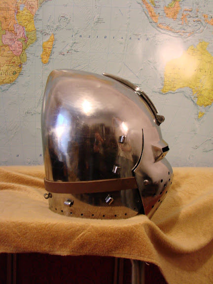

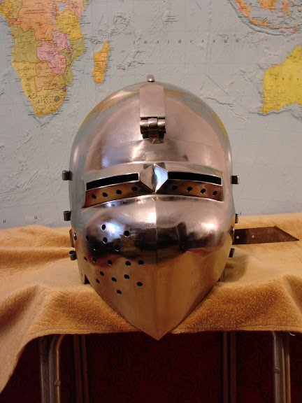

For sell: Bascinet Klappvisor
Posted: Sat Feb 27, 2010 11:41 am
by Jolly Knight
Bascinet Klappvisor
14G mild steell, mirror polishing, linen liner.
Size - 24-25"
New price - 350USD including delivery.
Location - Ukraine. (Or in the middle of the Indian Ocean)
Thank you for looking.

Jolly Knight's work is top notch. One of the nicest faces I've seen.
Lovely
Posted: Sun Feb 28, 2010 12:27 am
by Raynold of Wharram
Lovely Helm... Almost makes me want to get another one just because...

Helmet is SOLD! Pending payment!
