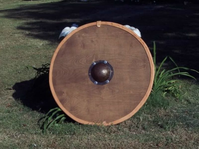

by Eirik
3/8" Euro Birch; 33" with a center boss from Hjalmr, edged with leather. Constructed myself with a drill and a jigsaw. Might consider going as small as 28", depending on your size.

by Eskil Lundberg
Eirik wrote:Image
Does Hjalmr have a website???
