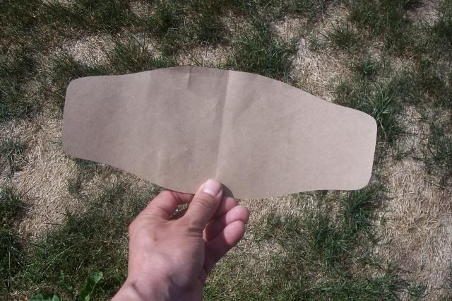

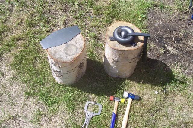

Having experimented with simple tools I decided to take the plunge and buy the dishing doughnut and hammer from Halberds. The whole transaction went smooth and fast-5s across the board! Using these tools almost felt like cheating and I told Hal so in a PM. I am mostly self-taught so I have to say if I can get these results, I think most anyone can. Ok, now for peekturs:
My pattern which I modeled off an old Stonekeep cop\/
The tools I used\/

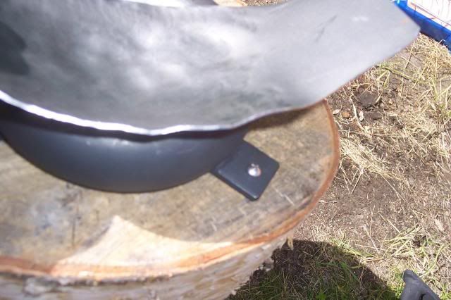

I pre-dish along the top & bottom edges with the rubber mallet. This is probabaly not needed but it seems to start the process easier\/

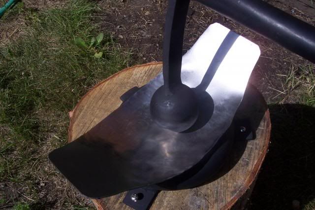

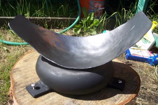

I then start with the hammer and doughnut around the top and bottom edges echo-ing what I did with the rubber mallet\/

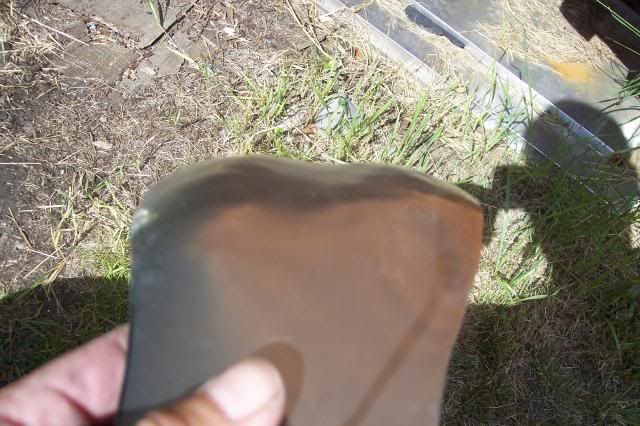

This is a side shot showing the profile starting to take shape\/(sorry for the fuzzy focus)

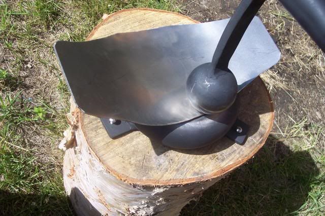

I then start to work the middle-no big hits yet since I'm just asking the metal to move with a lot of taps\/

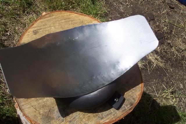

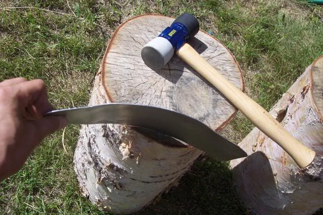

The edges will start to crinkle. I tap them down as I go\/

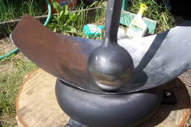

When the cop starts to take the dishing I up the stink a bit on the hammer in the center hits\/
After about 45 minutes of hammering I end up with a rough but service-able knee cop!\/
Again, I am a relative noob with a hammer so if I can do it I'm pretty sure you can, too! Time for me to start saving up for a planishing hammer and ball stake so I can smooth my stuff! Thanks Halberds! :D
