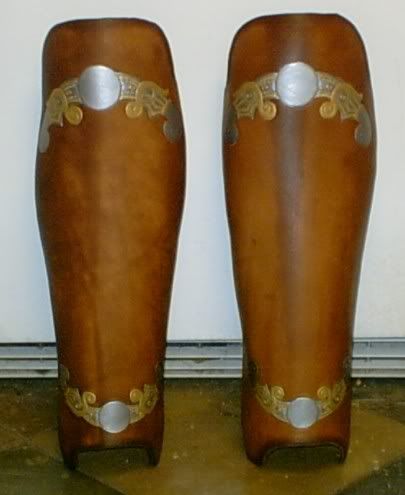

I just finished these, and they have a similar shape to those boots, with the exception that they don't go all the way 'round.
I was tryin' really hard to get what seemed like suitable proportions on them, and I think they turned out well enough. As you said, a lot of research is required.
-Gregory-

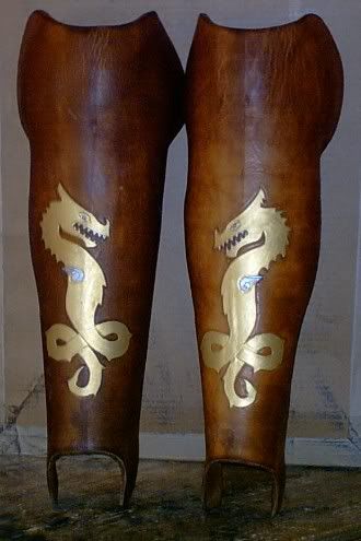

All my hardened leather greaves are dished around the calf area to fit to the curves you mention. Here are some pictures of shovel knee greaves. You can see the shaping around the calf. My shovel knee greaves are $110.00 and just plain greaves are $80.00
