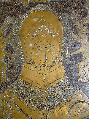

Hi all,
Was just wondering if anyone had any insight into the helmet/gorget/mail arrangement we see on Laurence Hastings, from the tomb of Hugh Hastings:
[img]http://effigiesandbrasses.com/static/monuments/original/laurence_hastings_s14_r204.jpg[/img]
It's a very interesting neck piece he's wearing there, and I've never seen anything like it before.

These things were somewhat popular in the first half of the 14th century.
See also:
Thibaut de Pomollain (1330, France)
Ramon Folch (1322, Spain)
I believe they also appear in art of the period but I don't have any of those images on hand.

Very interesting! That one from 1330 looks strikingly like a protosallet.
Thanks.

I have not seen the image that you posted of Laurence before, but if that's a literal copy of the image then the detail is pretty interesting and unique. The image of Hugh Hastings also shows a mysterious collar, and that is what was discussed in the thread mentioned above. I threw out some speculation there, but it doesn't really amount to much. The fact is that we don't have any surviving gorgets that resemble these pieces, they seem to be unique to English brasses by this decade (if not just this particular tomb!) and we have to assume just about everything about them.
I'll also note that since I wrote up my own speculation and used the references to the black color of particular parts of Hugh's ensemble, I did not realize it was a brass rather than a carving. So, the coloration of the reproductions really has no bearing on the matter.

And the image I posted is actually a rubbing of one of the mourners from the brass of Sir Hugh. The whole thing is very rarely shown all together.
