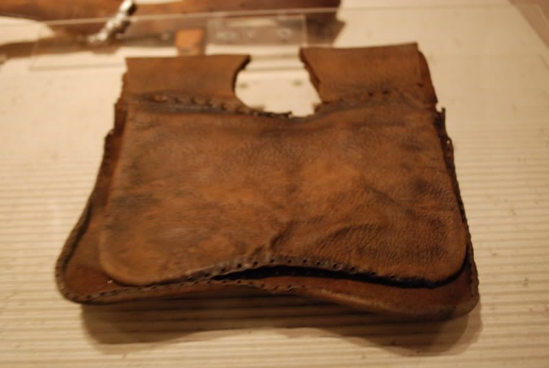

Here are some photos of an original purse I took at the final Goubitz exhibition:
I'm sorry for the blurriness, I hope they're of some use.

Those photos are quite helpful, indeed! I see that my stitching is on part, but the lacing used to hold the front and back together is rather surprising! I had no idea that it was actually so thin!
