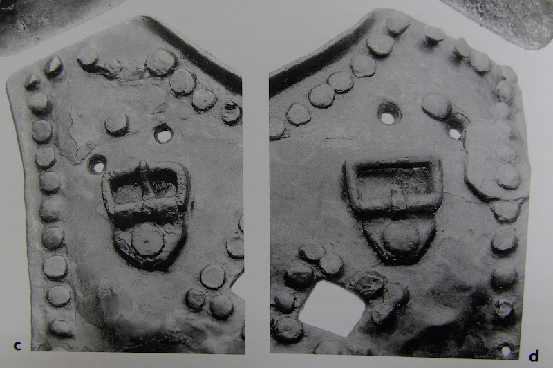

Here is a pic that we have seen before. It looks like a wire tongue to me.
Wire tongues were the "standard of the industry" in small pewter buckles, so I tend to think of then first; having made many grosses of them.

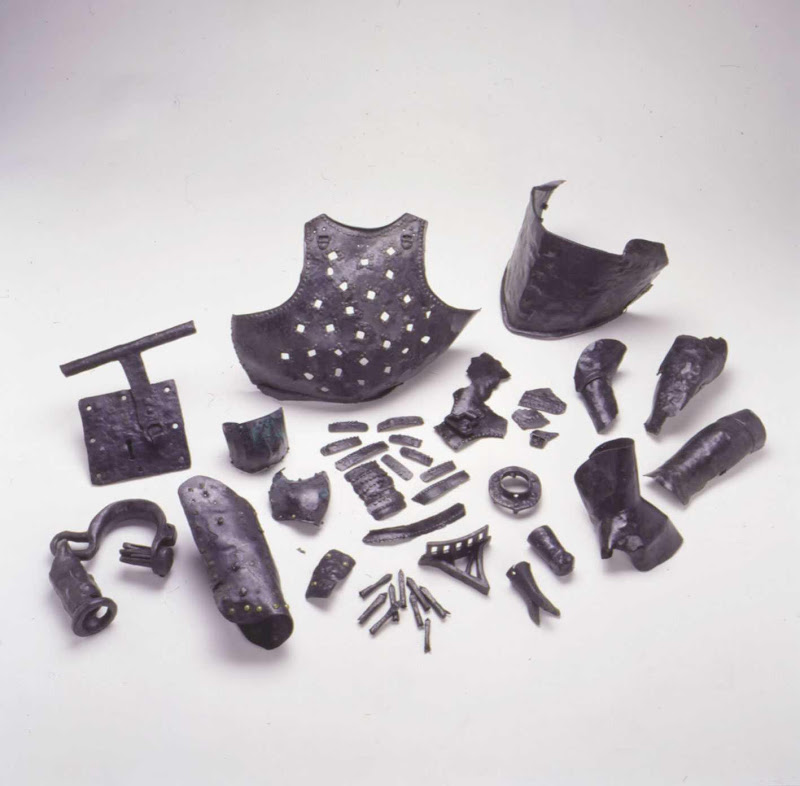

Here are some examples from 15th century showing tongues like Mac's.
This is from the breast plate in the Herbede find. (first pic is from the Brigandine book discussed in this thread)

Not to side line this thread but what the heck happened to that breastplate? Was it for the joust or something? All those holes?
Thanks for the buckle images.

Post by Signo »
For what I remember those findings have been made in a place that was damaged by a fire and the building collapsed, the breastplate was probably intended for some combat sport.
