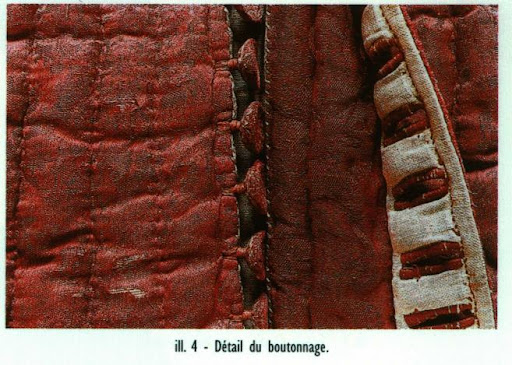

Here is a close of of the Charles VI pourpoint and you can see a visible whip stitch, gaps in the button hole stitching, and an irregular running stitch quilting the outside and this is a garment for a prince.
And yet it's still better than I can do with a sewing machine. :)

James B. wrote:Here is a close of of the Charles VI pourpoint and you can see a visible whip stitch, gaps in the button hole stitching, and an irregular running stitch quilting the outside and this is a garment for a prince.
It is also a bit old. You could do the buttonholes on a machine, and it would probably be close enough. I'm not sure when we get "modern" buttonholes with both tack&bar.
Yes and no. From and SCA perspective I often just machine a garments button holes and sometimes later I go back over them, but with living history you can see a difference up close. The thread used on the real garments is clearly thinker than the tread on a machine. Also my machine does a zig zag where hand sewn its a button hole stitch. Also the machine creates a long seem on each end were the originals don't normally have that.
