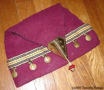

By the way, here's how my belt turned out:
Strap width is 1". That piece to the left of the strap end is a floating "keeper." I know that some keepers have been found but not out of sheet metal, so this is artistic license on my part.
While I was making punch-decorated brass stuff, I made a Birka style finial to replace the (much maligned) tassel on my "viking" hat.
The original artifact was cast, with granulated detail IIRC. However, I thought the punched decorated brass had a similar feel so I took some license. I think it is the right shape but in retrospect it looks a bit big. It's got a granulated gold fitting and a glass bead at the end (as opposed to the "mesh ball" that the original reportedly had).
O yeah...the shape is actually a four-sided cone, which is difficult to tell from this photo. For this I decided to try something besides the rubber "Poundo" leatherworking board to punch the brass against, so instead I used a piece of MDF as a work surface. SUCCESS!!! It made really nice defined dots. My next projects will be done using scaps of MDF for a work surface.
Tim
