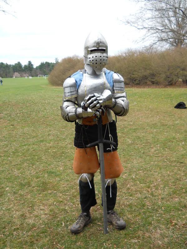

Re: 2012...Show us your kits
My first time in armour. I'm not happy with the legs, some buckles broke last minute, and that's why they're so low in the picture. I think I'll make some steel ones to replace them. I made some of it, bought others.
Beginning Armourer, Mafia Initiate
- Swete
- Posts: 1906
- Joined: Thu Jan 15, 2009 9:30 pm
- Location: Vogelburg, Gleann Abhann (Pollock, LA)
A buckle or cord going around the back of your thigh would keep them from flaring out so much.
And are those YOUR finger gauntlets OoO Cause they look good.
Like I said, both buckles popped as I put them on. The gaunts are GDFB, I just padded and gloved them.
Whoops. I missed thatAntonis wrote:Like I said, both buckles popped as I put them on. The gaunts are GDFB, I just padded and gloved them.
How are they working out for you protection wise? (the gauntlets)
Antonis,
For your first time in armour, you have the makings of a nice kit.
Ignoring the issues you are having below the waist, my biggest suggestion would be to get an aventail ASAP. There are some weird things happening between your upper chest, shoulders and helm that I can't place my finger on exactly why (very long neck), but an aventail should even it all out and make everything look much more cohesive.
Something that Chris Gilman said a bit ago (that I agree with) is to look at the silhouette as a whole and not the individual pieces. This is why the aventail is so needed.
Good luck and have fun!
Antonis wrote:My first time in armour. I'm not happy with the legs, some buckles broke last minute, and that's why they're so low in the picture. I think I'll make some steel ones to replace them. I made some of it, bought others.
If you're having trouble keeping your legs up, making or buying a c belt can solve a lot pf problems. It's pretty easy to make one. I used heavy canvas for the first one and wore it for a while before I could afford the leather to make a better one.
http://www.createforum.com/thegirlsclub ... egirlsclub
Your spaulders are hanging kind of funny too but I think it might just be the fit of whatever they are pointed to that's causing them to shift out of place. I don't know what sorts of sewing skills you have but you might be able to get some help in making a fitted arming coat if there's someone local to you who has mad sewing skills. You don't even need mad sewing skills to make one that will work but I had to have help with patterning mine so it fit right.
