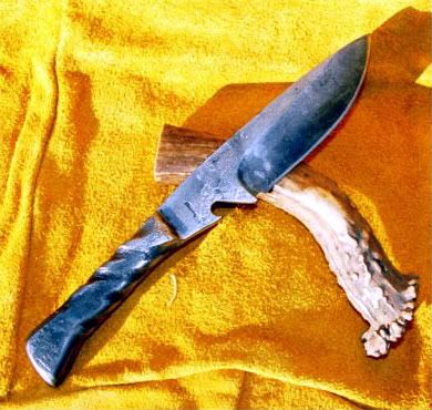

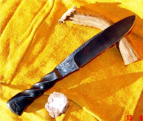

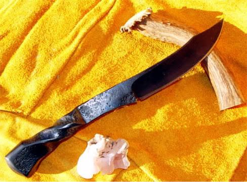

The track sections make great small repair anvils, the spikes make wonderful knives or tomahawks, the bolts are great for hatchets and also as dishing hammers... The clips are also good steel for a variety of projects.
Since you are close to crusher mills there is also a call for mill balls... especially in 2.5" to 5" range.
Here are a few I have done.

Zohar - I leave the head on the spike but I have a self built lil press that squeezes them flat for me. After that I shape them with the grinder into whatever pommel design I want. Keeps em balenced at the proper place and allows me to stretch the handle section some before twisting for a grip. Why wait for or pay for nitric? paint em up with some resist and drop them into some Muratic pool acid. Even sticky beeswax makes a great resist.

Zohar - if you like I can make you a couple RR spike knives... or a knife & a hammer handle hawk as a thank you in addition to covering shipping.

I have been warned by more than one person that the "high carbon" claim on some railroad spikes is a VERY relative term... high carbon maybe in comparison to a steel with next to none. Judging by the difficulty I've had with heat treating some that I grabbed on a trip down to West Virginia that had the good ol' "HC" stamp on them, I'd say that you'll be lucky to find one that has as much carbon as a chunk of 1050 steel.

Exactly! I'd have to dig through my notes for the exact number, but I thnk they maxed out less than what 1050 would have. If you think about the use of the spikes, they would never want them to be hard.Browin Auld wrote:I have been warned by more than one person that the "high carbon" claim on some railroad spikes is a VERY relative term... high carbon maybe in comparison to a steel with next to none. Judging by the difficulty I've had with heat treating some that I grabbed on a trip down to West Virginia that had the good ol' "HC" stamp on them, I'd say that you'll be lucky to find one that has as much carbon as a chunk of 1050 steel.
Personally, I've never made a spike knife and never will. It doesn't have the ability to perform as well as other steels. They do make good letter openers, conversation pieces, mouse hawks, and other tools. You can eek a little more hardness from a superquench, but that's about it.
I use pieces of the track for beater anvils. Rather than leaving them rounded, I milled the top flat.

I agree with Jamie to a point.
If you can't determine the quality of the steel it's best not to make a knife from it.
Where I do disagree is that all RR knives are bad and the steel inferior. After all, many very well performing, Japanese blades were and are made from steel that has no better performance than 1050.
Would I rather a knife made from D2 or O1 or even 5160? Yes...
but that's like saying a Chevy isn't road worthy because some people drive Bugatti's.
That RR spike knife sells for $35-40 versus triple that for a similar sized one in higher performance steel. The reason isn't that they are inherently inferior. The base material is far cheaper and they take 1/3 of the time to make.
No frills tool with the handmade look and old-timey feel that everyone can afford. Wonder if that's why Dr. Jim Hrisoulas a.k.a Master Atar, makes RR spike knives?

I will observe that the steel cutting edges of most of the tools in the Mastermyr find are 40 pt. steel. One virtue of 40 pt. is that it can be quench hardened in water, and does not, usually, need to be tempered. Once again, in abundance and homogeneity, probably a lot better, or at least no worse, than a lot of the bloomery and blister steel our ancestors worked with.
Junkyard steel rules apply, and each piece may need testing to assure consistent quality.
