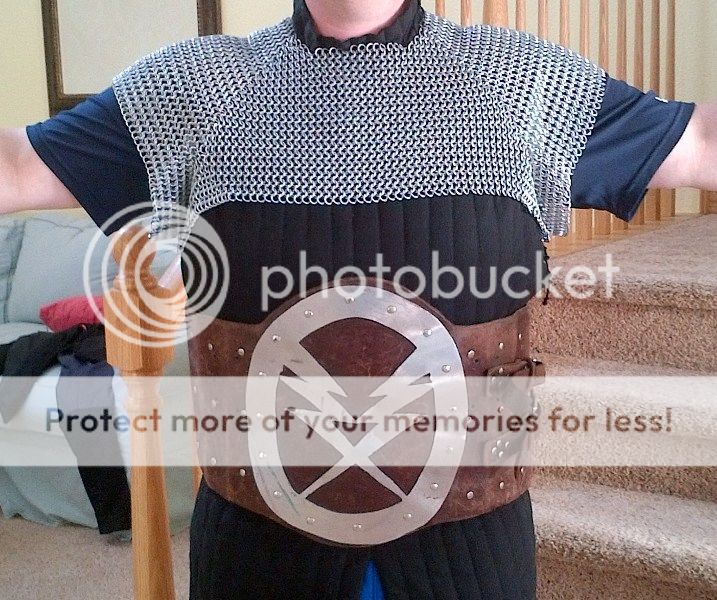

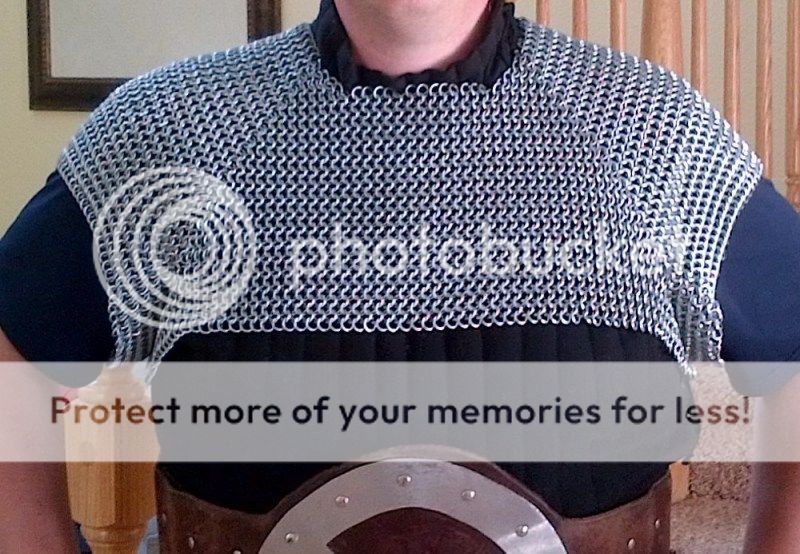

Here's some pics of what I have so far (sorry for the bad camera):
The belt is part of my old kit and will be redone to keep my kidneys safe but you can get the idea of what I'm shooting for. I'm going to add leather pauldrons to the final kit as well. Almost 6 weeks of fighting in it, 2 practices a week, and no signs of damage at all.

Re: Help me choose a chainmail ID for combat...
I try and steer people away from using the Bladeturner mail shirt pattern, and towards Trevor Barker's Butted Mail: A Mailmakers' Guide instead, as better tailored and more historical. The BT can give trouble raising your arm above horizontal once the sleeves are in -- which after all is really the point of making a shirt in that shoulder section at all.
