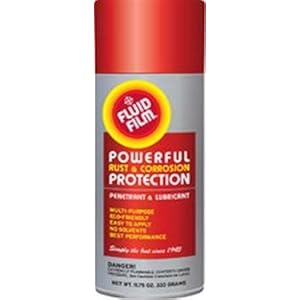

I use a spray lanolin called Pro-lan currently, but it's gotten harder to find. Sold as a marine lubricant. You can get spray lanolin for making water resistant diaper covers.
Re: Clear Protection for Mild Steel
http://www.amazon.com/Fluid-Film-Spray- ... B001OKBFBS
This stuff is fairly economical. It's what I spray my mild sheets with when it's sitting waiting to get used.
I've had armor sit in a bag for two years after hitting it with Fluid Film and not rust.
However it's not really durable: it will require a rub-down and a spray every couple uses.
Though come to think of it, I don't have much better luck with Johnson's paste wax, which is my other suggestion. (Though Johnson's is more readily available.)
