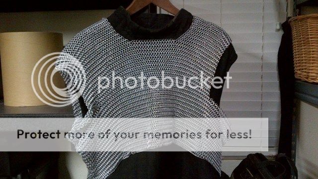

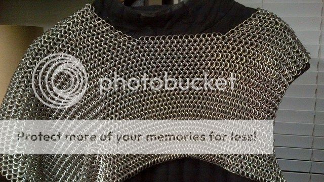

If I might be so bold, here is what you are looking at. Sorry for the unfinished pics but these are the only ones I have access to at the moment.
This haubergon is 2mm X 8mm ID woven out of SS. It is almost finished now and weighs in at 29 lbs. When its finally done it will probably weigh around 35 lbs. It protects alright, and has held up remarkably well under combat but is very heavy.
This shirt is 1.6mm X 6mm woven out of galvi. It weghs here around 11 lbs and finished should weigh 22 - 26 lbs. It doesn't provide any protection and isn't as robust as the other shirt. Still kinda heavy.
I've gone round and round about the weight and I'm now I'm looking into making riveted mail. For SCA combat the weight/protection rating is very far from ideal, even for me who is a big and burly dude.
PS: I used the score'n'break method to make the cuts which work very well IMO. Both shirts were tailored for a 52" chest. I have the patterns broken down section by section if you want. And see Konstantin I reworked them using the Trevor pattern.

Hmmm.... Now you've got me thinking. So are you saying that the lighter one provides no protection because it's smaller/lighter or because it's a smaller ring size? If its because it's lighter how will switching to riveted mail help? As riveted is lighter yet?thunderbolt wrote:
Or are you stating that with sca style fighting mail isn't that useful period and so go with as light as you can get away with and still maintain the look.
And yes please I'd love any help on patterning - which was another reasoning was going for butted - in theory it'll be easier to fix if I mess something up.

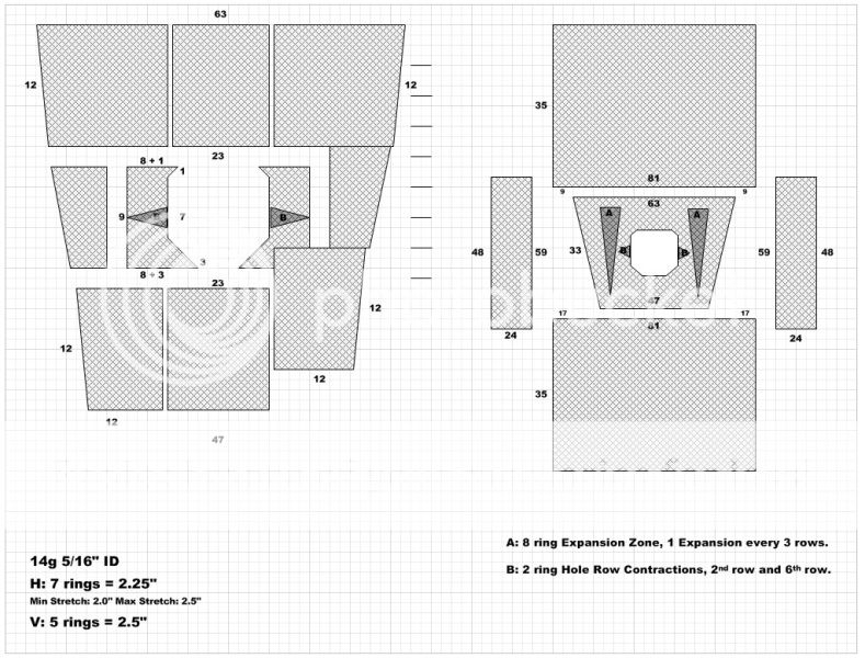

Here are the plans I used based on the Trevor Baker shirt. Again this is the only pic I have access to at the moment. When I get home I'll update it. I know for a fact that the numbers on the sleeves should be 45 on the shoulder reduced down to 36 otherwise the numbers are good. This should get you started anyway.
And Here is the Trevor site again:
http://homepage.ntlworld.com/trevor.bar ... r/mail.htm
**Just For the record I count rows as primary rows and connecting rows so every row facing left is one and the ones facing right are connecting rows and not counted.
