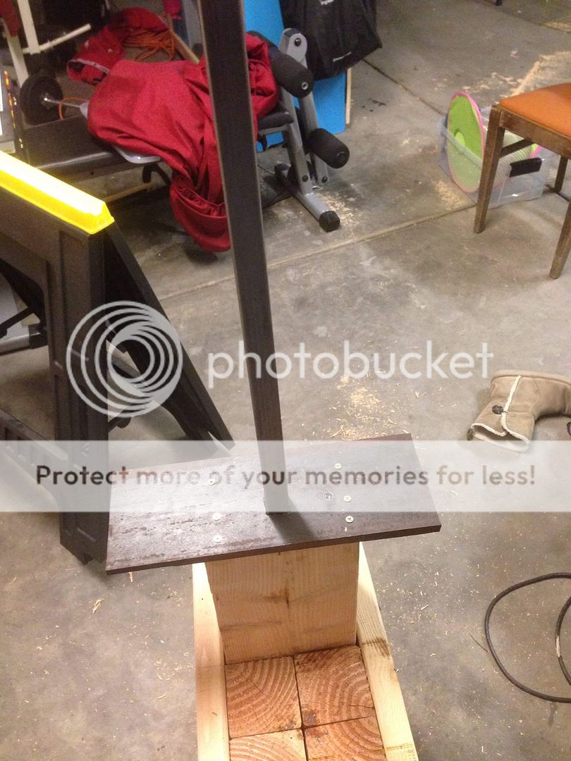

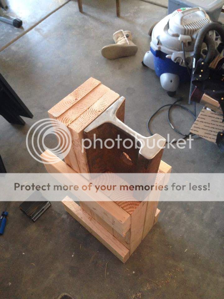

It's not a stake holder per se, but I am going to make something similar for stakes specifically next. This is my rr track anvil stand. Cost me less than 30 bucks and I used scrounged stuff to make it.
http://i538.photobucket.com/albums/ff34 ... wine64.jpg
http://i538.photobucket.com/albums/ff34 ... ydr2zz.jpg
http://i538.photobucket.com/albums/ff34 ... imfj2m.jpg
I did all of the work with cold chisels, a drill press and an angle grinder. Cutting out that square hole with chisels and a small sledge was a pain in the ass but it works great. The square tubing sits inside the hole in the plate down in to the wood where I drilled it out and takes hardy tools just under an inch square.
