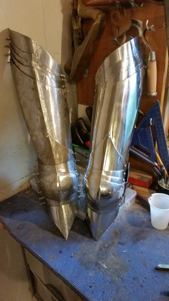

Hey everyone,
It's been years since I made anything metal related but I've got the opportunity to again now.
These are a pair of legs I've I started ages ago and never got round to finishing them, pretty happy with the result although they aren't exactly historically accurate they look okay. One thing I am very happy with was grinding down the domed rivets into a more pleasing flatter shape, the rivets I bought were are close as I could find but I've ground them into a new shape and that looks far more accurate.
Next is strapping but I've never really got that far before so some learning to do there.
Comments very welcome,

Re: 15th C Italianesq Leg armour - almost finished
Post by Mac »
It's good to see someone make cuisses that are as tall and slim as the real ones.
Bravo!
Post by Ian BB »
Mac wrote:It's good to see someone make cuisses that are as tall and slim as the real ones.
Bravo!
Cheers Mac, I'll take some better pictures later.
