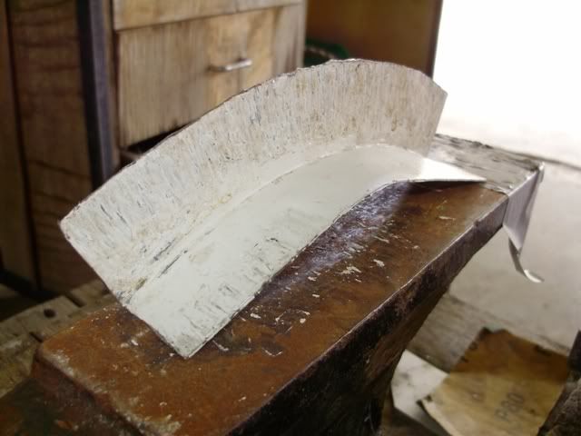

The other day I decided to practise my anticlasticability on a bit of scrap. I got a strip of steel about 7" long and 2" wide. With my vice, I bent it longitudinally 90 degrees, so that from either end it looked like an open 'V'.
Then I grabbed a cross pein, an anvil, and went to work. I put the open V on the anvil so that one of the sides was flat on the anvil and the other was hanging down beside. Then, with my cross pein, I whacked it, each hammer blow nearly overlapping the last, working from one end of the strip to the other. I tried to focus my attention a little bit more on the outer half of the half-strip (if that makes sense) to increase the stretch there rather than have lump thin metal near the medial line that had nowehere to stretch to.
I had the face of the hammer at right angles to the long axis of the strip. I didn't whack it hard, and I did two or three passes. After just a couple of minutes, the strip looked like this:

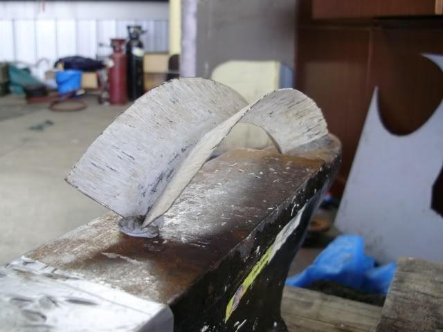

When I was satisfied(ish) with the curve, I turned it over, and started whacking the other half of the strip, in exactly the same way. I looked often to check for symmetry and evenness.
no more than 15 minutes work from start to finish got me this shape:
By hitting the part from the back onto the anvil, you get less marking on the part that will be visible. This means less cleanup work (yeah! ) :D
You can't really tell from the angle that I took the photos from, but the curve is pretty close to that on extant Gothic floating elbows.
So there you are. I didn't even bleed on this part, it's so easy.

I tend to work the opposite direction. Rather than pushing the metal along the curve, I will push it from the crease upwards. It seems to give me much more control with exactly where I need the metal to go, and allows me to get various shapes without an excessive amount of hammering.
