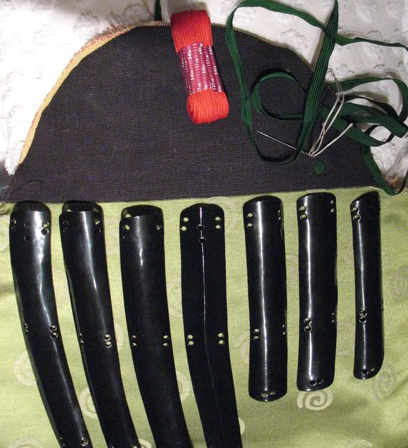

Mac- The second picture posted above is 3/8" material laced through a Noble Plastic Kozane plate so the holes are 1/8". The piece on the right is a piece of 1/2" material just shown for comparason. The material is quite a bit thinner than shoe laces or flat paracord so you can get a wider lace in a smaller hole. I'm working on some armour made form 16 and 18 gauge stainless so making a ton of holes in that material becomes a real pain. Smaller than 1/8" holes becomes a challenge fo me tool wise so wider material will be the way.

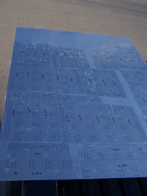

Kusazuri and sode lames ready to be cut out.

The big difference:
Braid is not shoelace, and shoelace is not braid. Braid is flat (ribbon) and one layer, while *most* shoelaces are actually flattened tubes (and thus by volume twice the amount of material you want or need).
Shoelaces are perfectly functional as sugake odoshi (and even okay if you're doing kebiki odoshi on solid lames), but if you're working with kozane they really mess up the scales.
Konrad, which 3/8" material is the green one? There are a couple of suppliers, and I'm not sure who you used. It looks perfect.
effingham
effingham

And they're both the Rice braid? Cool. I haven't worked with their wider stuff -- it might be just the solution to a problem I've been planning to create for myself.
Effingham
Effingham
Effingham wrote:Braid is not shoelace, and shoelace is not braid. Braid is flat (ribbon) and one layer, while *most* shoelaces are actually flattened tubes (and thus by volume twice the amount of material you want or need).
I'm not suggesting that one is the other. For example, shoelace doesn't have quite the right appearance because it isn't a ridged twill. And it's a bit more difficult to get shoelace to come out the holes correctly (more of a matter of developing the touch).
How does shoelace mess up kozane? It didn't seem to mess up my old stuff when I laced it...

Yep. The 1/2" product I bought was:
BNF-311-16-ON1002 1/2-inch kelly green nylon flat braid
The can also lacquer the braid at an addtional cost to provide addtional stiffness if that's desired for an extra 15 bucks a gross. I ordered unlacquered but it might be worth investigating to see if that might in fact be a better option for armouring purposes. They mentionioned that it does darken the color slightly but it might take some of the wavyness out of the material.

raito wrote:How does shoelace mess up kozane? It didn't seem to mess up my old stuff when I laced it...
It's just too bulky. If the kozane are properly rigid, it makes the tops jut out a bit, and that makes the whole thing just a bit too... well, thick. Makes it harder to fit into a tight dô without serious fiddling.
