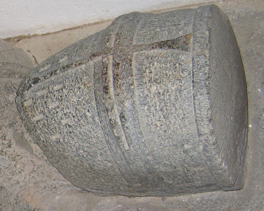

This is the helm I am working on concerning the top question I posted earlier. I still have a lot to do but the top is my main obstacle now. I have a forge so I'm going to try to bend the edge at an orange heat to try to avoid the crinkles. My model is the effigy of William de Lanvalei at
>www.themcs.org< It can be viewed by clicking on history, then "headgear worn by knights...", and is the third one down.
I used five plates as seen on one of the original helms on another site because I have no idea how the helm in the effigy was constructed. Thanks for all advise and I hope the link to the photo works.

Yep, link's good.
Okay, so your barrelhelm is an earlyish form with a large top. An exterior-fit is right for this era of barrelhelm. The rectangular breaths are also good; you may want twice as many. Later barrels and greats might have the right side more ventilated than the left, but the earlier models didn't differentiate between the sides. In the Prankh helm, they mounted a wrapper plate in front of the ventail plate as a reinforcement. Effective, but it increased its weight.
Working it down hot should practically eliminate any problems you encountered with your top cap. Should some wrinkles begin to develop, do a run around the edge of flattening all the waves down again.
I've poked around http://www.themcs.org/ to see if I might find William de Lanvalei's image, but no luck so far in trying to work from your description. Perhaps a direct link via that URL button at top right?

Dear me, I'm still such a duffer. Thanks much, Milan. {Then I tried actually following the directions... first History, then Headgear Worn By Knights Pictoral Timeline, found just below the picture of the very purple gentleman...}
Serferdude, see the slight dishing to the top cap I was talking about elsewhere?
