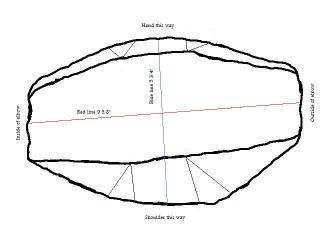

I'm creating the pattern for my first piece of armor ever. It's an elbow cop that will be used as hidden (or mostly hidden) armor. It's basically a soupcan knee for the elbow.
I used a manilla folder to get the shape and forming right. It looked and felt pretty good.
Let me show you a basterdized version of a picture of the pattern and then I will ask my questions.
The outer line is the entire piece of material I used to fashion the piece.
The inner image is... the shape it created after I creased and folded the the material to fit correctly, then cut it in hald and matched the ends up flattened it letting the center overlap.
The 4 triangles are the material folded out of the way.
What shape metal should I cut to achieve the final piece? The inner, the outer, half between?
Remember that this is my first attempt and my terminology and such may be incorrect. I will happily answer any questions that will get me closer to my goal.

Couple of questions so we can try and help.
Why did you cut the piece in half? Was it re-welded after that?
You said you creased the material to make it fit, was that the triangles you cut out?
What exactly is the question, how to make the cop fit or where to cut some more, and if the latter what is the goal of the cutting?
I am sure some one here has some ideas but a little clarity will help us help you.

Has not been made except out of a mannila folder as of yet.
The triangles could be cut out and then welded. If I did that I'd have many less problems and quetions. But I want a one piece dished elbow, and I can't weld.

Ok, you want to make a wingless, low-profile elbow that is SCA legal and you want to construct the pattern yourself and you can not weld.
I take back any previous comments about a great-helm being the easiest thing to pattern. THIS is the easiest thing to pattern.
Put on your elbow pads. Bend your elbow and with a flexible tape measure have a friend measure the distance from the inside point to the outside point plus any extra that you wish to cover. On me that's maybe 10" (I don't have pads near by.) Now measure in the other direction the distance you want it to cover.
On a piece of paper draw and elipse (oval, whatever) that is whatever long by whatever wide. Cut this shape in 16ga steel and debur the edges. Drill a hole in a block of wood, grab your ball-peen and pound the steel into the hole. In the beginning it will move easily but will only want to curl in one direction. Force it open and repeat. Eventually you will have a lumpy mass that is almost the right size.
If you have an anvil it is more productive to hammer from the inside to push out any low spots. If you don't then place the elbow over a ball (even your ball-peen in a vice will work) and hammer down the high spots from the outside.
Eventually you will have your very own first piece of armor... and will realize that people make armor because we are insane. :)

Sean, so the outside will suck in as I dish the center?
I'll have access to a nicely stocked armoring forge, I just want to make sure my patterns are ready before then.
And for whoever asked, I'll be using 16 guage cold rolled steel.

Halbrust wrote:Sean, so the outside will suck in as I dish the center?
Two things will happen as you dish and they amount that one happens more then the other depends on the metal properties, thickness, distance in both directions, face of your hammer, shape of your dish and other factors.
If you cut a 4" square of 16ga steel and scratch 1" grid lines on the face and then dish it you will notice that at about the curvature of a soccer ball The sides will be sucked in like ) (. If you measure if with a flexible tape accross the gap is may be 3.5 and over the arc maybe 4.1. If you measure the corner to corner distance you will see proportionally more stretching. If you look at the grid lines in the vertical and horizontal thy still cross at 90 deg but at the grid lines on the angles will decrease from 90 to maybe 75.
If you keep dishing deeper you will notice more stretching, but primarily on the diagnal axis. The extra material stabilises it's location and prevents it from being sucked into the center. From the side the metal will tend to flow into the dish more instead. Eventually as you go from the diameter of a baseball down to a tennis ball, the curvature is sharp enough that the deformation is amost all stretch regardless of direction.
If we apply the same principles to an elbow: In general we can consider the pinky to shoulder direction to be like the vertical and the metal will want to flow into the dish. The long direction is like the diagnal and is more likely to stretch... but will still generally flow into the dish until you get to your deepest dishing.
Stretching isn't bad. Remember, you can always re-cut it smaller after dishing but it's a pain to make it larger.

And the more I play with it now the more I'm liking an egg shape. Larger on the outside than the inside.
