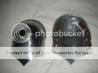

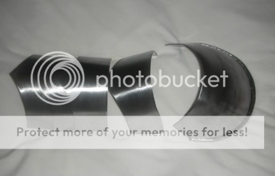

So, these were my first spaulders. I patterned them after the great instructions (thank you Eric!) described here: http://www.arador.com/construction/spaulders.html. Yes, I know. Dish them more!!! Hey, first sets are just that.
Then, I tried a more ambitious 2nd set. Here, I've formed and edge-rolled them and given them a first sanding 120 grit. I'll probably get some 4oz leather rather than trimming my belt leather, but it was a good idea at the time, I thought. Although a cheap tool is a good way and Belts are yardsales and Thrift stores are almost always available for $1.
I want to figure out adding brass trimming. That makes them look so nice!
Finally, I am so appreciative of the words of encouragement and support I receive here. I'm a Scoutmaster, and have spent many an evening around a campfire doing just that to my scouts. So being on the receiving end is very much appreciated.
