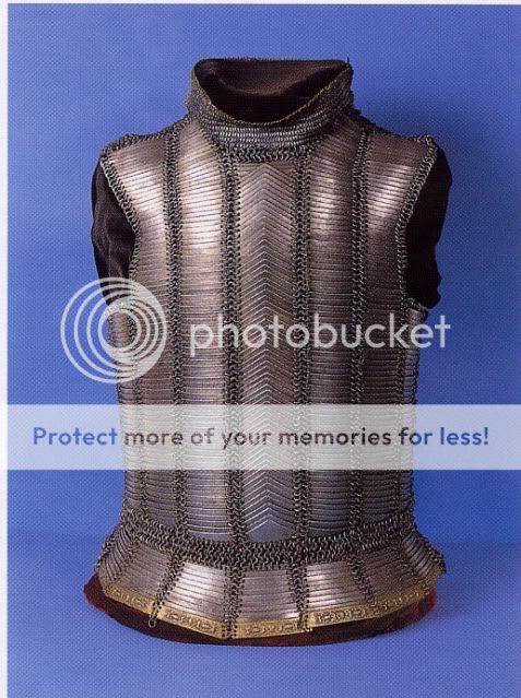

BTW are you trying to make something like this:
If so, please upload pics when you are done. I've always wanted to make one myself.

very similar to the pic bhaiduk, im using *much* larger leather plates with 1/2in 14ga galvy rings.
each ring goes through the 4 surrounding plates in corner holes 1/4in from each side.
this allows the rows to butt up next to each other very tightly with the upper row overlapping the lower about 1/2in scaling downward.

bhaiduk and snakejawz, I do like the armour pics there, could you please identify the period and name/type of the armour. It appears to be a varient of lamellar, please correct me if wrong.
Posted: Wed Apr 07, 2010 8:21 am
by bhaiduk
The picture I posted came from: http://www.plcommonwealth.org/articles.htm It's the document labeled section 4 "Arms and Armour of the Commonwealth" (Sorry should have included the link orignially). Basically, it's a type of Russian or other Eastern armor. I would suggest checking here:http://web.archive.org/web/20071012033618/www.geocities.com/normlaw/page9.html. It's a great article about mail and plates in general not only the berkheter.

Linse wrote:bhaiduk and snakejawz, I do like the armour pics there, could you please identify the period and name/type of the armour. It appears to be a varient of lamellar, please correct me if wrong.
I recall that one of the variations on the small plates linked by maille is Turkish and known by the name jazzerant (sp?) I've always thought it a particularly cool kind of armour.
