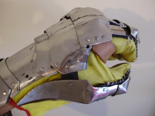

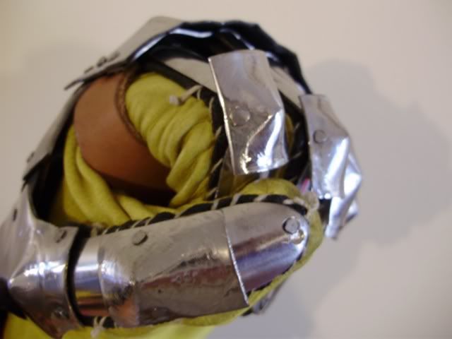

Aussie Yeoman
Posts: 916
Location: Canberra, Australia
Post by Aussie Yeoman »
Well your fluting looks about a bajillion times better than my first efforts.
I have to say though, you're better off calling these Lord of the Rings rather than High Gothic, as, to my knowledge, there were no High Gothic Demi Gauntlets, though I'd be happy to stand corrected.
I'll second what Konstantine said about the fingers. They aint hard, unless you bite down on them.
My first bit of advice: try to advance the progress of your gauntlets equally. Don't make one, then the other. That's what I did, and now I am sorry.
More tips:
Here you can see my first set of gauntlets. You can see that each finger has two plates and one gadling. Why? It's historical, you still get plenty of coverage that way, and I was lazy.
Here you can kinda see that the finger plates are riveted to a strip of leather, which is then sewn onto the glove. Always cut your leather tabs bigger than you think. Always. When your fingers are straight, the finger plates should almost touch. This ensures that when they're bent, the gadling distributes the force of a hit onto them, and not your knuckle.
Here, on the plate that goes over the knuckles, you see three rivets. The one on the far left attached the knuckle plate to the metacarpal, the middle one attaches that skintone leather strap which goes across the palm, and the one on the far right secures one end of the knuckle rider plate, which is a narrow (1/4") wide strip of 18/20g mild steel which was convinced to take the same shape as the inside of the knuckle plate. The finger tabs are riveted to this.
