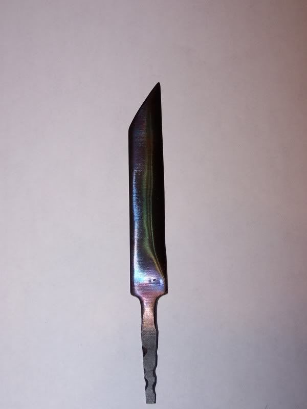

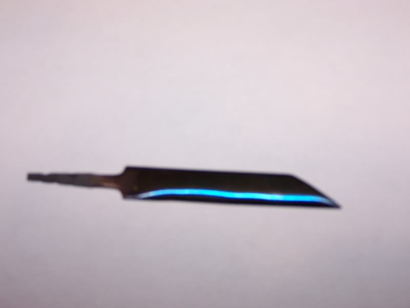

Posted: Sun Jul 25, 2010 10:21 pm
by Blackoak
I am shooting for a small serviceable knife, not ornamental. A functional sharp to go with a soft kit.
The current blade in question is only 3.5" long. It has held a great edge after treating it. I made it a little bit sharper.
Pics are hard to take but one side is a beautiful blue.
The other side is a purple around the edges and a golden center with a few purple spots.
If you don't think I have to re-temper it for it to still be functional, I may just leave it for the coloring. :D
This is only about the sixth blade I have done and am pretty novice with some of it.
Uric
Posted: Sun Jul 25, 2010 11:16 pm
by Destichado
You'll be fine.
Tempering only works one direction. If you start with straw, you can go further to purple or blue. But if you go to blue, you can't come back to straw without rehardening first.

Posted: Mon Jul 26, 2010 1:04 pm
by AwP
Guessing from the color, you have that tempered to about where you would want a sword, not a small knife. It's not a big deal (assuming the file wasn't case hardened which would mean it's just mild steel except the outside skin) a bit softer than optimal but still usably hard (also assuming that you didn't get it even hotter than the temper when you were grinding the blade).
If you make another one or redo that one, here's my method. Get a magnet (a hard one, not a bendy fridge magnet) and a heat source. Heat the blade until it's glowing just a bit and see if the magnet sticks, if not put it back in until it's a bit hotter and check again, if so put it back in anyways just to get it a hair hotter (blacksmiths call the optimal color for hardening simple steels "cherry red" though I've never seen a cherry that color) then take it out and let it cool to "room" temperature. Do this two more times, this is called "normalizing" (at least in smithing circles, industry defines terms a little differently) and it relieves strain in the blade and makes the grain smaller. Heat it the same way one more time, and then QUICKLY quench it in oil. Test the edge with a file, it shouldn't bite at all, it should just slide over the surface almost like glass. If it does bite, repeat the heat and quench but use water instead of oil, if the file still bites after using water then you probably have a case hardened file, useless for your purpose.
To temper it, put it in the oven (I like the toaster oven if the blade is small enough to fit) in a way that it sits evenly (notice how your blade is different colors on each side? that's uneven heating) and start lower than needed, maybe 325-350F, and leave it in for an hour and then take it out to cool. For a small blade of simple steel (which most good files are made from) you want the color to be a yellowish bronze color. If it didn't turn yellowy bronze then turn the oven up 25 degrees and do it again, repeat raising the temp until you get the right color, then do it one more time at the right temp. Don't worry about the extra tempering sessions you did at lower temps, it won't hurt anything.
Hope this helps.
