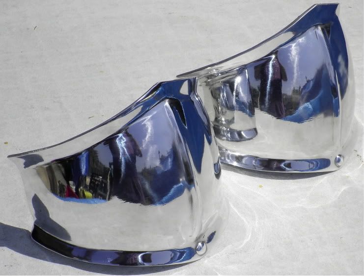

Aussie's method is good but if you got a peice thats already formed and dont wanna loose the shape then do what the youtube video shows which employs some of the technique explained by aussie. I do alot of flared edges(i like them) and the best way is lots of hits and passes,starting with the innermost and work outwards on the flared edge. while doin that your pounding the metal to stretch it so to avoid flattening out your peice and cracking your edge.
Image these are made from aluminum and require delicate forming or they will crack. wish i would have looked up more videos before my trial and error phase hehe.

anything thinner then 0.100 thick t6 6061 cracks,so thats what i use and its very strong so it holds up for sca combat pretty good.

Amalric,i would use 0.100 thickness aluminum for everything thats gonna get hit in sca combat often and complex formed. some parts that are overlapping plates dont always need to be as thick.
