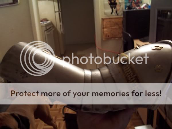

Jess, this is just an idea. Totally ahistoric but perhaps a variation on a Roman manica. small segments from the gorget down the shoulder and upper arm. It could be hidden under the jupon.
just a thought. perhaps by getting rid of the large upper piece it will all collapse on itself when your arm is raised but drop into position as the arm is extended.

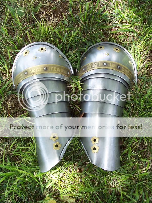

I have zero problem with my shoulder armor restricting movement. They're spring steel, so I hardly notice I'm wearing them at all. My shoulder measurements are about the same as yours. From my neck to the point of my shoulder is just over 5 1/2".
I just have a dog collar gorget though so my spaulders don't make any contact with my gorget. They're pointing to my arming coat at the point of the shoulder then strapped in one spot. However, the range of articulation on them is excellent.

ok. Mrks this is fascinating because your elbow doesn't appear to be elevated higher than your shoulder. It's parallel to both your shoulder and the ground. I'm rasing mine a lot higher. My elbow is frequently angled higher than my ear, sometimes almost near the top of my head.
I need to figure out if that's because I'm short and need the angle for my sword lines or if that's unneccessary and should be eliminated. Obviously, if I don't need my elbow that high it is going to make it a heck of a lot easier to get functioning shoulder protection.
Isabella, what you have is gorgeous, but I know from experience there is absolutely no way that will work for what I want to do.

Jess wrote:ok. Mrks this is fascinating because your elbow doesn't appear to be elevated higher than your shoulder. It's parallel to both your shoulder and the ground. I'm rasing mine a lot higher. My elbow is frequently angled higher than my ear, sometimes almost near the top of my head.
No problem, I hope you get it sorted out.
