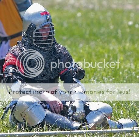

Above is what it looks like after the edges have been rubbed off.
I'm in the Midrealm red and white here, it has been freshly sprayed about 3 months before this.

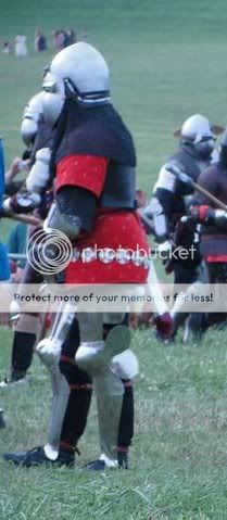

Freshly sprayed here.

Thanks Jess! :D I think your mail looks fantastic.
