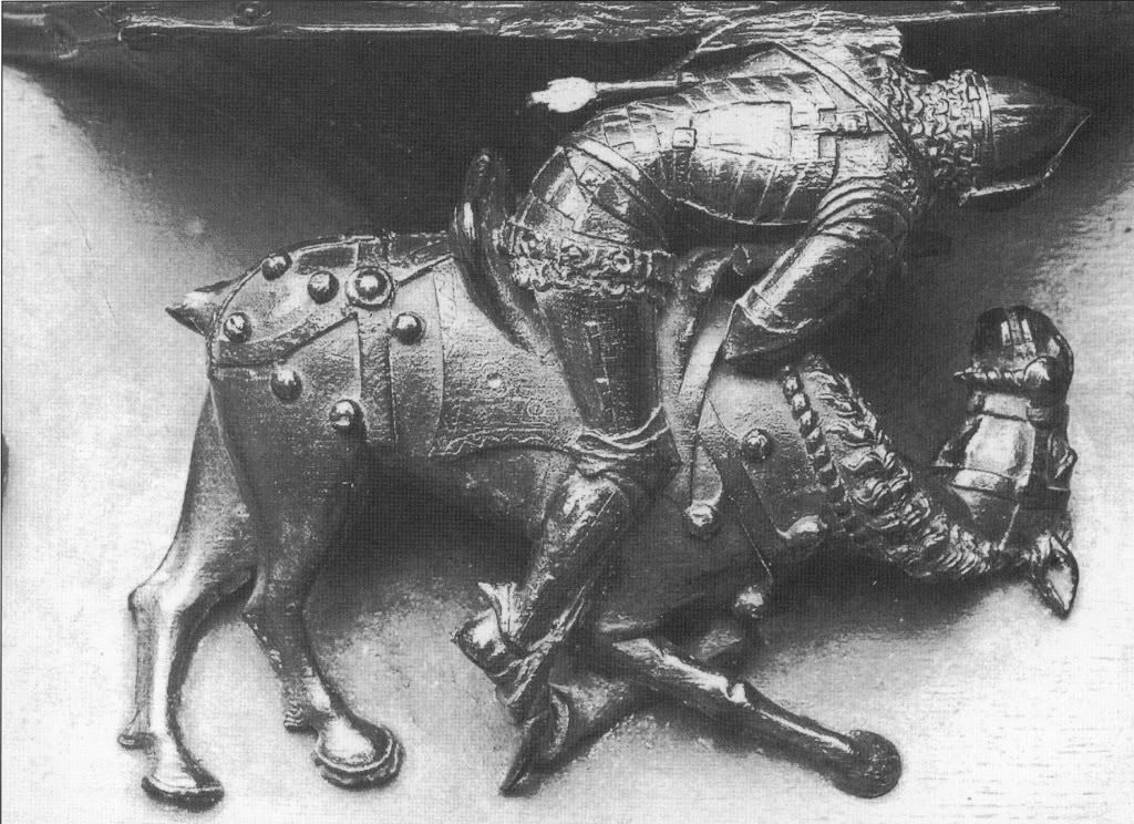

I'd go with a longer coat of plates. See: Effigy of Rezzo von Bächlingen (c. 1350)
Posted: Sat Feb 26, 2011 1:08 pm
by ushumgal
Galfrid atte grene wrote:I'd go with a longer coat of plates. See: Effigy of Rezzo von Bächlingen (c. 1350)
Thanks Galfrid! That's a lot closer to what I have been looking for. Though ideally, I'd like something a bit longer yet, to help protect my rump. Do you know of any COPs longer than this?

That long CoP is deceiving I think. I doubt that the plates extend so low all around his body, as they would be a great hindrance to movement. Those plates probably only hang low in front and do not offer any hip protection.
After doing much thinking and looking around on this subject, I have surmised that there is no period way to cover your hips with a CoP. The only option is to make the stomach plates a bit longer and wider, so they hang lower and extend a bit over the hip socket, though the protection is still minimal.
