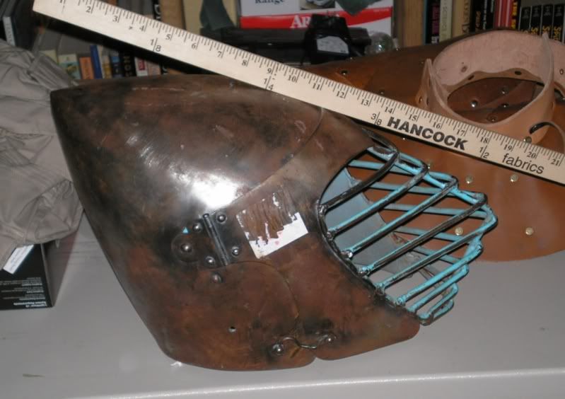

The helm in question-
The sneck hook for the visor might be an issue with the vervailes and aventail..
Its set mighty low.

You could always take out the sneck hook, and put a spring push-pin up at the brow. Wouldn't be in the way of the vervailes or aventail, and it would be easily gotten to by a gauntleted hand. If you're worried about a random blow managing to hit it and pop open the visor, install two.

The sneck hook is awfully low on the side...
I had thought about removing it completely to clear room for vervailes, but I may experiment a bit first.
The helm is HUGE.
Its way larger than my head- I'm not quite concerned that its too large for me- but even putting the vervaile line below the hook, theres still something like an inch and a half from the edge to where I think they should go.
Clearing out the padding and cleaning things up is the first priority.
I do not have a welder- but I could get one, and the grill I am thinking of doing is the old standby of 1/8" thick, 1/2 or 3/4 inch wide steel barstock, drilled for quarter inch rods and the ends flattened and riveted to the edges of the visor.
I actually thought I might try making a pigface for this helm, but I need a bit more practice before I am willing to devote the time to something like that.
I had some vague, weird idea of a cutout, pigface frame with perf panels in the cutouts...But that seems just a little silly, now that I have the helm in hand.

Pad, chinstrap, and attach camail and see what the balance for the whole thing is really like before you go nuts chopping things up with an angle-grinder cutoff wheel. Room for glasses or athletic specs is a crucial design consideration here. You said built for a 24"-circumference head, and pretty huge at that, but circumference of the helmet, measuring tape under the visor, visor lifted, will clue us more quantitatively about how much padding the maker thought the customer should have. Bascinets fitting glasses under the grill need some room there at the corners of things. You have there a 1390s type back-point, and had I such a hat I wouldn't change its profile for the world, not even Were diu Welt alle min... Such extremes of pointiness were a late form of the 14th-c. bascinet. The visor is not too sharp to be legal. You'll want a full rig with globose breast to team with this one.
Sounds like the previous wearer had a smaller head than yours; re-do and re-stuff this basc as required, and I'd break out the Dremel and drill bit (or the R-W #5 jr. @ 1/16" punch & die) for making the authentic little stitch holes around its bottom edges and face edges for stitching in a period, quilted bascinet-stuffing -- this is a chance for a major upgrade to a fine old hat! A simple one, too! Does it get any better?! Marshallate-pacifying skeletonized squidgey-foam may be framed within the hat, hidden by the stuffed hood, as a last ditch stopper. Easiest source of squidgey foam is to cut up a gardeners' kneel pad -- those things that look like soft cutting boards.

Exactly. It never would be. Ever. It's making a nice helm nicer yet. And is not this making long and long overdue? What do you figure you're doing for vervelles -- post? Tunnel? Custom built, handmade by you, or quick & dirty? You will likely want to flare out the sides of the visor to give space for the camail's temple triangles to fit in there. This will not be extreme -- rawhide-mallet stuff. Use a camail strap that rides a little above the bottom of the helmet, right around and paralleling the bottom edge, and the temple doglegs rising diagonally up the sides of the helmet, the vervelle line of the temple triangles slanting above the sneck. Get the doglegs tall enough that your temple triangles be tall enough to really hold the camail's chin area well upon your own chin, and line it in there for comfort too. Have a slightly padded liner to the camail also, for right shape. You can hide ventilation eyelets in there if you want (that's SCA-Engineered school of armor design right there), and that will wholly conceal any safety gorget you use. Watch that you may have quite a space between bottom front of bargrill and where your chin and face actually begin. You may desire to insert a welded-in crossbar there to bar any freak thrust shots coming inside and up your face, relocating your nose.
And that sneck hook: it's fairly big. It's also fitted so close and neat that it just might hide underneath your camail (even a liner, if you attach it the unproven way at the vervelles, under the camail strap) and you'll still be able to get at it from beneath the camail, by feel.
I wasn't thinking in terms of globose- more like a large-plate brigandine.
Though that is a good suggestion.

Not sure what style vervailes I'll be doing yet.
I may buy a set from Windrose-though the large brass cotter pin idea has merit.
I could make my own too- But time is more of an issue for me than the money is once I hit the summer, as thats usually my busiest season for contract work.
I'm not fond of the tunnel style made from bent over flat stock though, so I won't be using that one for certain.
(I just don't like the look.)

And tunnels wouldn't be right for a late-model backpoint anyway. Posts were in long before then.
Even large-plate brigs would be next-century. Some variant of late-fourteenth globose would be ultra-correct. Or a circa-1400 corrazina -- same chest profile, plus fauld lames.

If you go with extensive redesign of the demountable visor ref'd and shown in your other thread about this helmet, do you think there is much scope for wider peripheral vision? There's a pretty big face opening under the broad margin of the current visor, and the bargrill seems almost narrow. If you build another visor, you're going to want some soft-mallet time on it to get it smoothly curving like the current visor, which blends so nicely with the hat.
