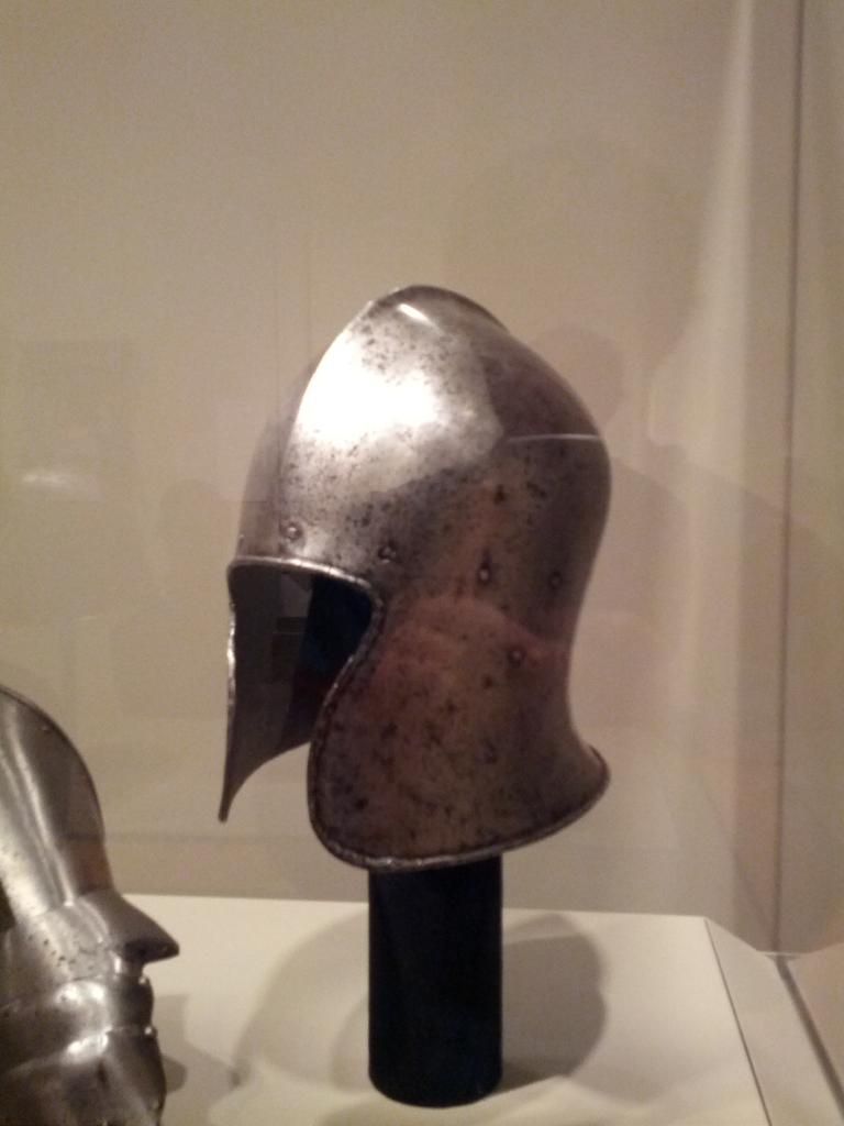

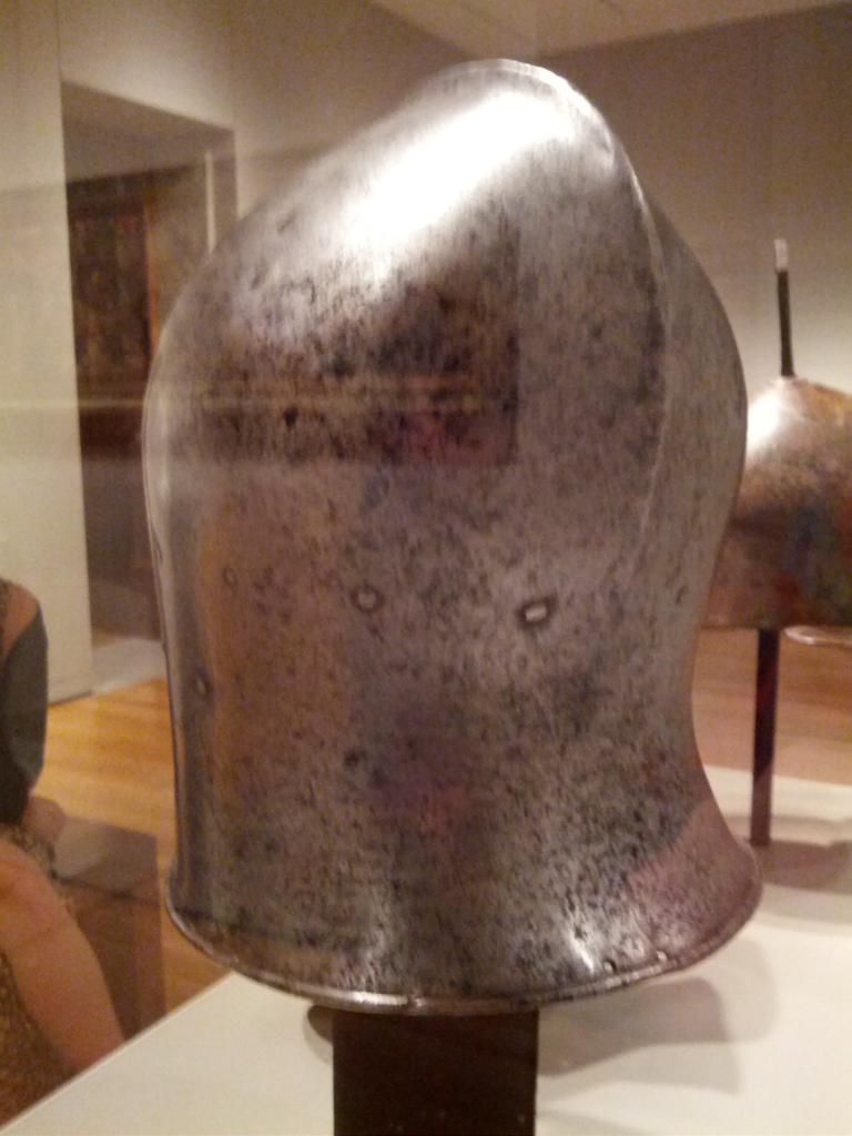

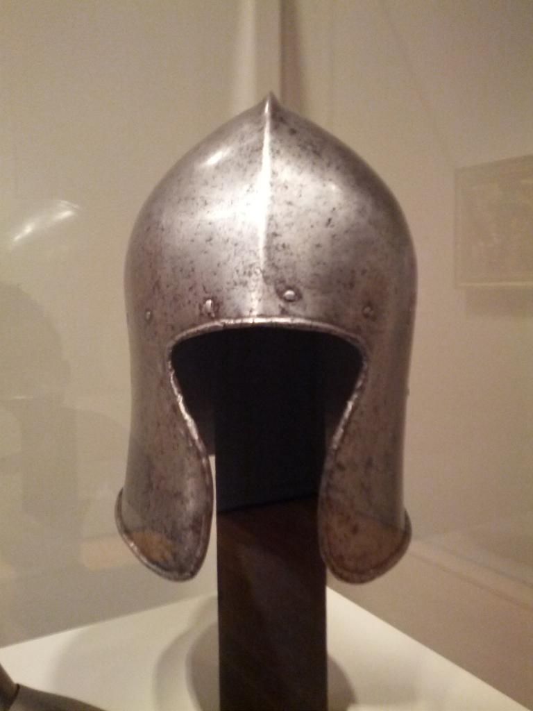

Photos of the finished piece, along side photos of the original.

I'm going to add a liner and chin strap, so all the rivets will be there to complete the look. One thing I'm not sure about though. What are the two holes right above the rolled edge at the back for?
