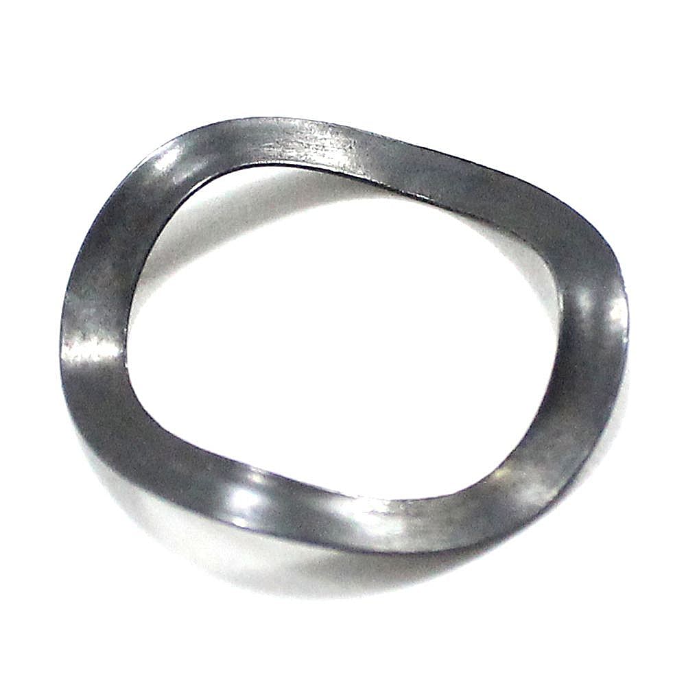

Do you mean a washer like A: or like B?Sean Powell wrote:Now you can add a washer, spring washer and nut on the other side of the pillar. You can adjust the spring so your arm moves but is not floppy.
Best, Indi

C, Basic flat washer: https://images.homedepot-static.com/pro ... 4_1000.jpgIndianer wrote: Do you mean a washer like A or like B?
Best, Indi
You COULD replace the spring with your washer B (Also called a Bellville Washer or a disk spring washer in American)
or with a curved spring washer https://www.globalspec.com/ImageReposit ... 6c8b10.png
Or with a a wave washer:
https://s.sears.com/is/image/Sears/PD_0 ... J250002-Z4
A picture is better than a description. This is what I would build to do what you are describing:
