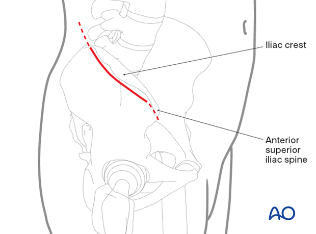

For most breastplates, the waist is just above the superior iliac crests.Batteredshell wrote: ↑Wed Apr 26, 2023 4:56 pm Ok, so onto the cuirass and faulds. I was wondering how far down a cuirass is supposed to cut off. Right now I have it cut off about at the belly button. Is that normal? I plan on making faulds that will be attached to it.
This allows the waist to be narrow, and the weight of the armor to be born largely by the pelvis. If I were to guess from your pic, I'd say that's about one or two finger widths higher than what you have. It's important to note that the iliac crest is higher toward the back and lower toward the belly. This means that the waist of the breastplate can slope down if front. Depending on style, this slope can be barely noticeable, or it can be quite extreme.

So where you say the cuirass should end- you are talking about the small squishy area between the bottom of the ribs and the top of the hip, right? Also, that post you linked was very helpful for visualizing how it should be shaped and much more. I just love a good diagram!
Re: Batteredshell’s Cardboard Armour Questions
Yes. The waist of the typical cuirasse is in the space between ribs and pelvis. Note that the navel is not a rreliable landmark. It's relationship to the skeleton varies from person to person. Likewise one can not rely on the idea that the waist is "at the level of the elbows". The elbow location not only relies on the lengths of the humeri, but the height of the shoulder joints. That later varies wildly from individual to individual, and may not even be the same from left to right. Ultimately it's the location of the pelvis; and specifically the iliac crests that matters. Luckily, one can find the right place easily enough just by poking around.Batteredshell wrote: ↑Fri Apr 28, 2023 12:22 pm So where you say the cuirass should end- you are talking about the small squishy area between the bottom of the ribs and the top of the hip, right? Also, that post you linked was very helpful for visualizing how it should be shaped and much more. I just love a good diagram!
