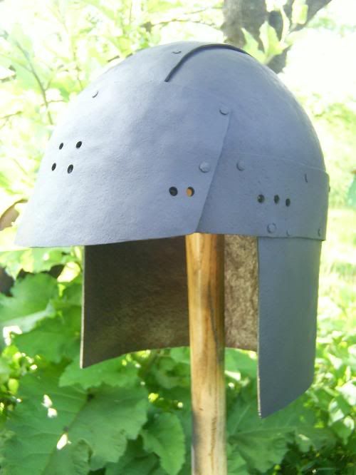

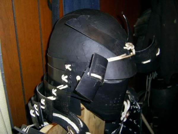

Ok, so I got the kabuto finished, at least for now, untill I can come up with a better shikoro and bug crest thingies. The underplate is done, the paint is on, and it seems to look ok, to me. I might need to flair out the back, where it rubs the neck, for a comfort issue, though... Found out after the paint was on...
I also fixed the miazashi, so that it doesn't look like a baseball cap visor, I cut off a bit so that it is more streamline with the rest of the helmet. It doesn't hang down in front of my eyes now, yay!
Now for the Somen...
Any critique is of course welcome! Just remember, I will be replacing the shikoro with a decent one, once I find some more plastic, and I am making a matching somen, next.
Thanks for looking!

General commentary:
More rivets. Especially on the visor. You want it to stay where it is. :)
Second: check the profile. The visor should have more of a "beak" -- look at any WWII or Vietnam–era US Army pot helm and look at the shape of it. That's *exactly* what you want for your zunari.
Effingham

more rivits, eh?
Yeah, good point, I'll do that. Do you think I should ad more rivits all around, or just on the visor?
About the shape...
Yeah, Next time I'll make the visor extend out more, but I will use thicker steel for that, like 12 guage. This was actually easier than I thought, I will make more of them, I would like to try all sorts of Zunari shapes!

In general, I'd space my rivets between 2-3" apart -- definitely no farther.

Effingham,
Well, if 2-3 inches apart is ok, then all but my miazashi is rivited ok. I'll add a few more rivits on the vizor, thanks for the info!
