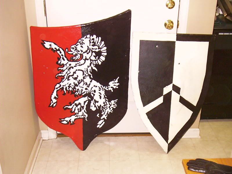

2 layers of 1/4in birch ply wood glued with water proof elmers. Cut to shape. Use GOOP to glue on a 3/8in nylon rope to the edge to act as padding. Then layer on a run of canvas strip that has been saturated in more wood glue. This only covers like an inch on either side just folded around the edge. Then cover the face and an inch or so around the edge and on to the back in more canvas saturated in wood glue. Let it dry and paint to taste. Strap and tap. NO there is no edging other than the canvas. Never had it not pass inspection but YMMV. Oh and i use a center grip oval so i don't know how well your leading corner will fare with heavy beatings but it would be easy to reinforce if needed and wood shields are expendable....

This is my method:
2 pieces of 1/4 birch glued together with gorrilla glue. Put in the press and let dry over night. The next morning cut it out. Then screw in 3/4" aluminum L shaped edging on the back all the way around. (lowes, Homes depot ect.) with some small screws around the edge of the shield. No seams on the cheilf or leading edge though! Make cuts where needed to bend on the side that gets screwed doen NOT on the side that will be bent over. Then place on anvil and fold eding all the way around the shield over the edge. This forms and edge with no sharp corners (sword safe) and is very flat against the wood. Then over the edge with 1 layer of canvas. (2 if the back wont be covered). The cover the back with canvas and then the front. The back will lap over the edge to the front & vice-versa. To attach the canvas. Mix 2 parts elmers white glue to 1 part water paint the shield and both sides of the canvas so its soaked through. Place on shield and clamp all the way around. Let dry till morning. After the shield is throughly dry and covered with canvas cheep acrilic paint works wells for painting on the shield. Intriicate devices can be carbon transfered to the white canvas and then painted in. This is the method used for my heater, my war shield & my buckler (except the buckler is not laminated its solid plywood since its flat). mine works well and easily passes inspection. It also doesn;t have that nasty hose look going on. Ask his grace Cuan about the shield I had at Gulf Wars this past year. Oh btw the shield on the lef has galvanized bolts to hold on the hardware & the one on the left has zinc plated. As you can see the galvanized holds the paint alot better. I dont fight as much as I like but my shields last a while. YMMV.

Here are the construction basics for mine:
Wood: 3 layers of 4mm birch ply for curved heaters, 1 layer of 12mm birch ply for rounds.
Glue: Ponal 3 waterproof PVA. Have used Titebond II during my time in the states.
Curving: I use 5-6 ratchet straps and put steel "U" profiles on the edges of the board to get an even curve.
Edging: Thin steel band around the critical areas (i.e. leading corner of a heater). Rawhide nailed over that.
Decoration: Shield fronts are covered in canvas (again with the use of waterproof PVA). I use Acrylics for the paintjob.
