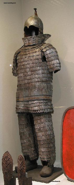

Why don't you use this?
Image Even as it's chinese, I think that it wouldn't look out of place for a NE kit.
Posted: Mon Jan 16, 2006 11:22 am
by T. Finkas
Ahriman wrote:Why don't you use this?http://www.vikingsword.com/vb/attachment.php?attachmentid=6194&stc=1...
Wow, what a great harness. I can see what looks to me like Scythian/Sarmatian influence there. What's the date on it?
And I like that other one that was posted. It looks rather "Bronze Age" to me, like the gorget from the (Hellatic Era)Dendra Panopy. I don't know how it works with that fellow's kit from an historical angle, but it's mighty handsome.

Sorry, I only know that it's chinese... a guy posted it at the forum at vikingsword.com. I've kept it only as it was interesting even to my NE maniac eyes... :D
Maelgwyn: nice pic!
Clinker: I thought that romans used only locking scale, not lamellar... am I wrong? :?: BTW, AFAIK Folcric wants to portray something Near Eastern...
Hm, Flolcric, what do you want to portray, exactly? :D
This armour is north Chinese or Korean, 4th-7th centuries most likely, as this design was replaced by the long lamellar coat. A figurine of a horsemen, unearthed in central China, depicts a soldier clad in identical armour and riding a fully armoured horse.
