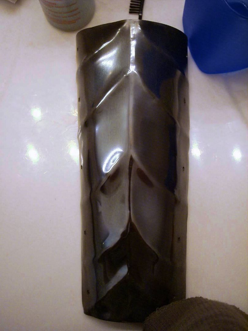

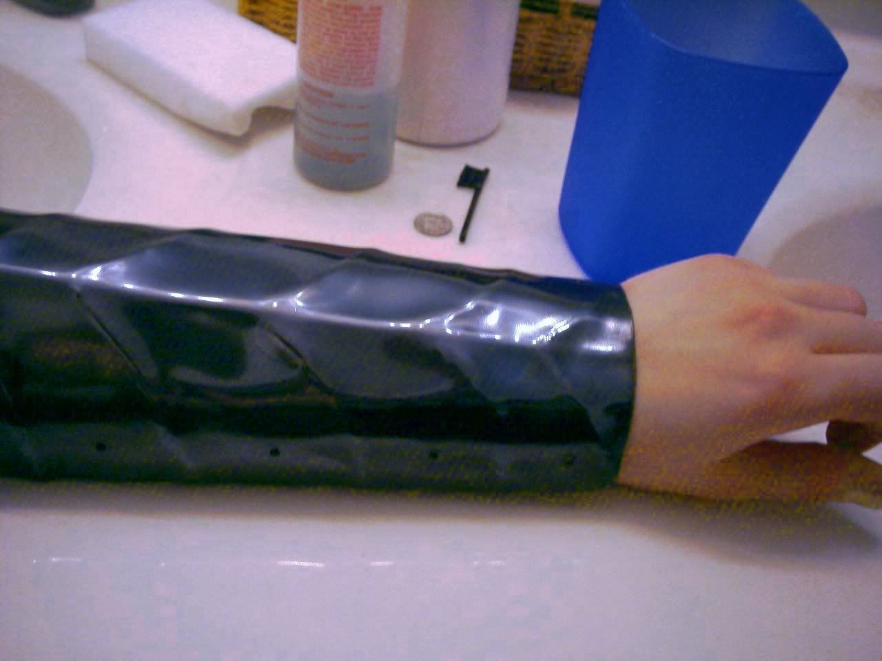

Well, i've had this done for a while, but I just got a digital camera so i figured I'd post it, though i'm not sure it's worth posting. The pic is of a laced vambrace (there's a pair, but the other isn't shown), only covers the front half of the arm (hence the holes for laces). It's 16 ga. mild with fluting for strength (It doesn't fit my arm too well because it wasn't made for me, made it for a friend). All reasonable criticism and opinions is welcomed. Some color variation can be noted in the pictures, mostly due to the lighting/camera, so i'll mention that it has a bluish tint in real life.

rolling the edge by the wrist will help a lot with comfort. or just belling it out a bit. right now it look like it will cut into the wrist some. Looks good though.

Nice fluting....
I like the blend...
Thanks for the pics....
