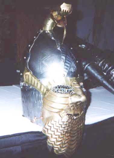

This is the progress pic so far..... It's starting to take shape. No?
http://home.armourarchive.org/members/h ... OG7B&W.jpg
Perhaps some personality can be hammered into this helm yet.....
I had to use screws to assemble it this far...
It was supposed to be TIG welded but I don't know how yet.
More pics Saturday.....

The trick... is to not go so fast... allow the metal to go with the flow.
Your hammering should produce a noticeable effect on the work piece.
Go with the flow...when that happens.... Move the metal in the direction you want it to go. This should produce the desired results.
The first time I saw that... it killed my flow. The very sight of it flowing.... interrupted the process....
Takes a little time getting used to I must say....
This is Gorps Helm pic so far:
The helm top is coming along as planed. Need a lot of more work on the back slats to look more like hair.
I am thinking of polished heat blue for the hair. I like the highlights and reflections in that... Black chrome is very cool.
One never knows until it is finished.... does one?

Progress 12 pic.
Well.... I would like to thank the photo shop guys for the design help.
This is prog 12. Pic.
It is clear taped together as I start to lay out the rest of the rivet holes.
It will be bolted together before it goes to the welder.
Ps: Acetone burns cuts on your fingers...... but it sure gets rid of the sharpie marks.....
I had a visitor tonight... a big black tranchula... It came in... walked around then went back out the door. I asked him if this helm should be "Sir Fredric" or something and the tranchula did not say anything.... Therefor; it is still Gorp.
I was shooting for Oden, or something Norse.... God like....
Woops..... I lost the bottom teeth....

This is the pic of the back so far. I used the slat back design.
http://home.armourarchive.org/members/h ... prog14.jpg
My welder man is out on vacation for 2 weeks... so I started bolting it together.
It is fluted with a modified raising hammer and a common RR spike.
Struck all from the outside over the RR stake to raise the lines.
Ps: Where does the bargrill go, or should the eyes be 9/16"?

Sir Mord,
Yes I put in a little eastern touch with the scalloped bands, glad you noticed.
I always wanted to do a top like that but never had the chance.
It sure makes fitting the bands easer.
Seeing how this is fantasy and the sky is the limit.
I am also going to add a nice removable horse tail plume to the top.....
That should add to the fantasy. After all... it is my fantasy and their are no rules. Yes?

This is some "how to" on the nose, by far the hardest piece for me.
http://home.armourarchive.org/members/h ... rpnose.jpg
http://home.armourarchive.org/members/h ... epound.jpg
The nose pattern was shaped with kitchen tin foil over the nose on my face, to get the rough look. Then it was drawn around with a sharpie. I cut the nose out of the tinfoil and spread it out flat. Then I added about 1/4" all the way around for trimming. I then cut the pattern out with my plasma torch. The shaping was done in the tin/lead alloy block and over small ball stakes and RR spikes. I used a small tinsmith chasing hammer to planish out the lumps.
I hope this will hold you over a bit until I can get back to work on this project....
Your local metal pounder and part time tool maker,
Thanks for the pics Azommin, cool helms. I like to see how they represented the hair, that helps.

Yes my child... I spent the evening cutting things out with the Miller plasma torch and reattaching them with the Miller TIG...
I even used the stick option to make ears on the new dishing dough nut.
A couple of holes on the drill press.... botta boom... it was attached to the work bench.... The first time I ever, used a dishing tool that did not bounce around on my bench. I like it....
The dishing dough nut with the flange mounting ears is my best invention yet....
My new toys are so far beyond me... I feel like a newbie....
I welded copper, brass, bronze, steel and aluminum tonight.
