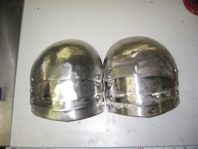

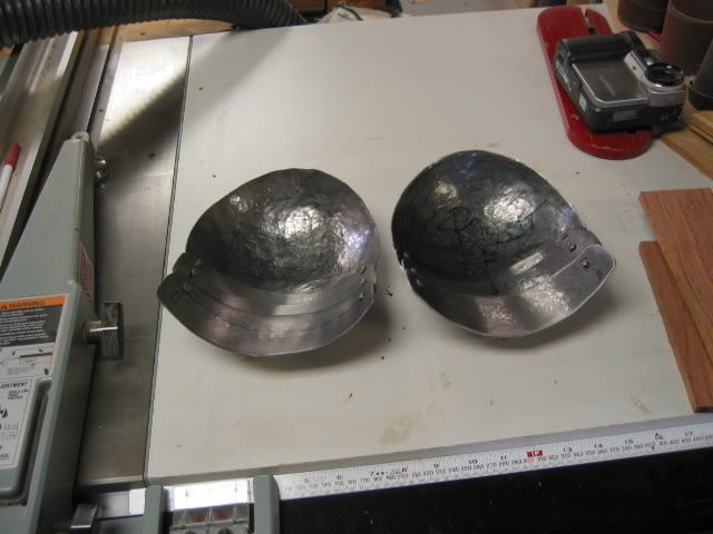

ok, just finished up some spaulders.
they are 14g. I am going to be using them for practice fighting, thats why they aren't the prettyest things in the world.
however, I have run into a problem. I have now succesfully made 7 spaulders. each one gets much better. but my problem is, thats all I can seem to get right.
I have started a norman spagenhelm 4 times, and yet I have not been able to get it to work.
what do you think I should try to do next? I am tired of spaulders, and I don't have the skills for a helm yet (spagenhelm to be precise).

Listen, brother, I'm attempting my 4th try on a helm and its been the same run-ins time and time again. But with every try, I do learn at least one lesson before I get too pissed off and melt it with the torch or trash it.
Have you thought about trying some elbow or knee cops? Good luck!

Make a Spangenhelm.
If you don't challenge yourself, you will never get better. Don't start with a 14 ga. spangenhelm though, maybe try a 16 ga. the metal moves easily and you can establish a pattern that works. Plus it only runs about 10 or 15 bucks a try.
Good work on the Spaulders, they look nice.

Post by dragonjohn »
Yes, Yes
Make the helm!!
you dishing looks great, start with the strapping, get that straight , then fill in with the panels, adjusting as you go.
I started with 18 and 20 guage and learned to adjust the patterns for my kids. lots of lessons learned there!!
keep on try'in :)

I'm going to run counter to the recomendations to keep trying Spangens. Not that spangen helms arn't a good second stage project but there are other options that may keep your enthusiasm up. A 5 panel great helm is also a good step up project. Only the top needs to be dished and depending on how well you flare edges it may not require that much dishing. You can also do knee-cops with lames. Not very different than a tight spaulder with solid articulation lames. You can learn good articulation with practice. Gorgets are also simple in the 2 piece variety and more interesting as a spanish collar variant. You can experiment with dished panel basket hilts if you do SCA.
Things to avoid are large pieces where if you mess up you throw away a lot of material and anything with highly evolved shapes (greaves, helms with ridges or flared backs, anything with heavy fluting) These you should save for later.
Good luck. Keep posting pictures.
