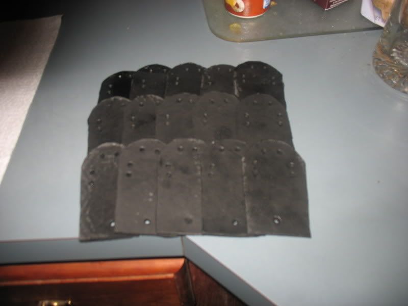

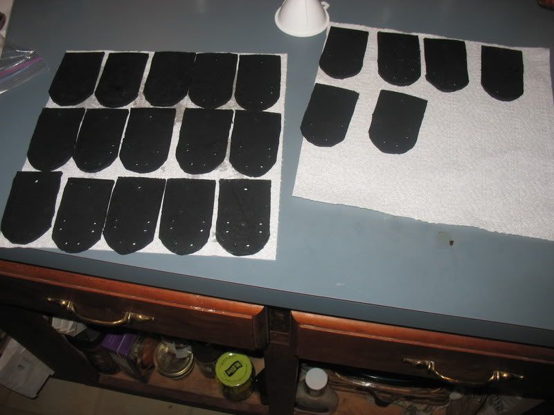

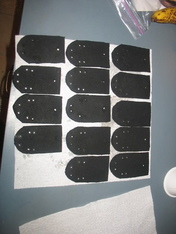

Well here we go...
Some of my first few batch cooling
Some more

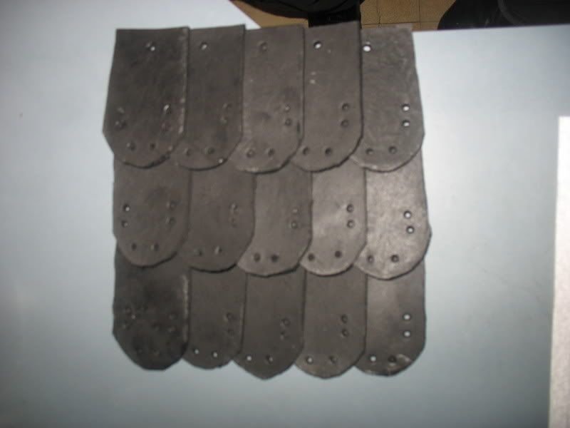

The way its probobly going to be laced
Alternitive to lacing it the normal way, incase I want to make a "fantasy" armour.
More pics to come as I continue the project and accually start lacing them together. Each scale is was impregnated and rather stiff--I think I did a decient job; though that reminds me I need closeups.
