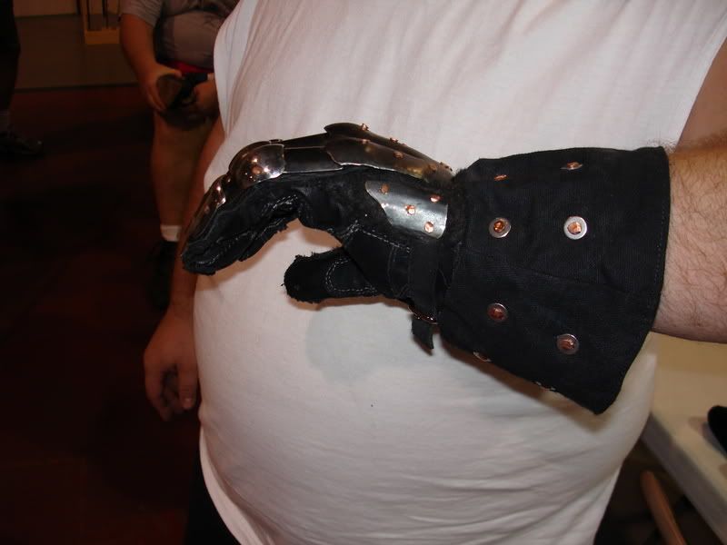

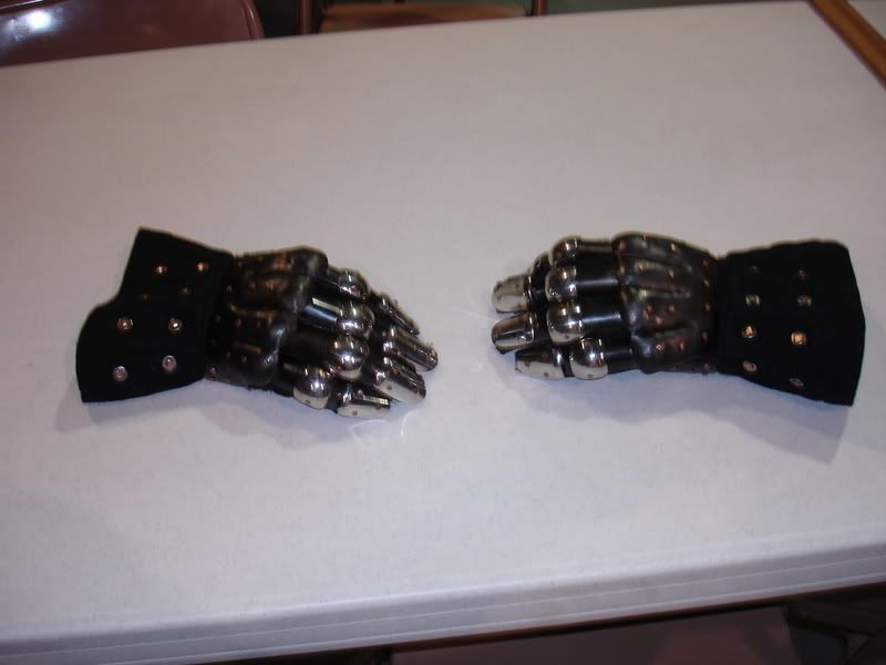

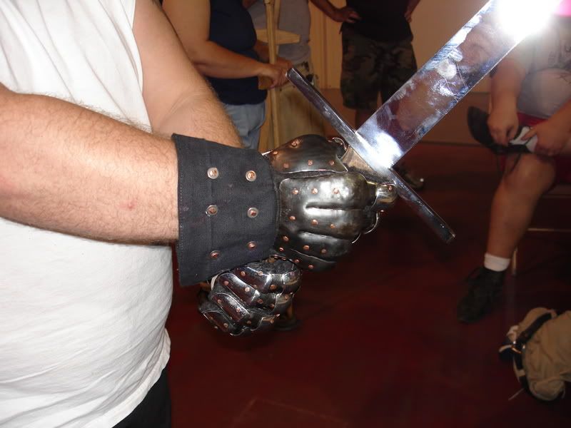

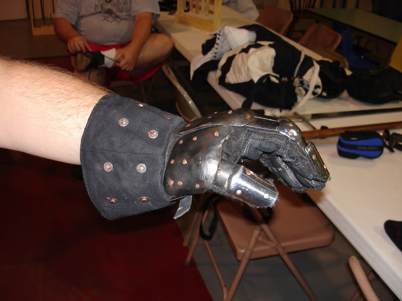

These are the lastest addition to my kit. The gloves are goat skin with wool padding on the backs and canvas cuffs. The sewing is from my Lady wife. The fingers are Stainless Steel tips and knuckles with mild steel flats. They were bought from Clay Moore in kit form. The rest of the plates are mild steel and made by me. The bluing was done by me. The rivets are all copper. There are some flaws as this was the 1st time I have made a set of these completely. The left gauntlet was my first and has the most flaws. They are serviceable through. I feel they will serve me well though in SCA & WMA.

The finger pieces where premade and labled with the holes drilled. All I had to do was assemble the pieces and attach them to the leather after applying the blueing. Those then were attached to the gloves, before the other pieces.

I specifically asked for a kit form from him for the fingers. I also asked for mild steel fingers with stainless tips and knuckles specifically as it fits with the colour scheme of my arms and the rest of my kit with the mild steel blackend. As for the price I will say it was a good price and you should contact him on the forum for his current prices as I have had these pieces for a few months and he might have had to rise his prices due to material cost. He was very helpful and sent me photos showing the steps in assembly. A great guy to do buisness with!

Nice work, but I have some constructive criticism: The pieces you made yourself look un-planished, and the curves where you cut them out aren't smooth. Planishing requires some armor- [or bodywork-] specific tools, but you could have smoothed out your curves [as opposed to just deburring] with no more than a file. A small, light flat-faced hammer can be used to 'polish' the exposed peened end of your rivets into smooth domes. Finally, and to me most glaring, the creases between the knuckle domes on your metacarpal plates look sloppy. Once you've got those laid in, you can go over the same crease very gently, moving your chisel only very slightly between taps, to tidy it up.

Your right Gundo. Like I said I had made a few mistakes. I could have taken longer with the planishing, And my creasing needs some work. I did all the work with a harnour freight sheer, wood hammer handle, a auto body hammer, a ball pean, a leather mallet, a shallow cast laddle dish from ebay, a ground down chisel, a piece of metal bar (the non-pointed end of a broken jackhammer bit) a 4.5 inch grinder and an awl. I also don't have a whole lot of experiance in this. This was the 1st set of finger gauntlets I made and I have also made a set of 1/2 gauntlets in the past with a simular pattern. Thanks for the pointers and the constuctive critisism. When I next do something like this I will definately referance it.

Nope not worried at all. I trust em. They are Clay more fingers like Roibeard said and I have them padded with 2 layers of wool, which adds a little extra proctection. I only had a slight sting with my hand laid across an anvil while I hit it really hard with an oak handle. That worse than anything I should see in the SCA realm. They are have a curve to them when wrapped around the handle of a sword which gives them a glancing angle to reduce the impact. I feel plenty safe. Can't be worse than the hockey gloves I've used for years.
