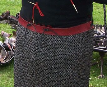

I have my fauld stitched to a belt (without closure/buckle) which is in turn pointed to my arming doublet. This makes the maille hang nice and straight and you notice the weight much less than when you belt it on your hips.
This is the only picture I could find of how it's attached to the doublet, but it was when I just finished it. I haven't trimmed the maille here yet and normally the leather doesn't hang this long, but it is pointed straight to the doublet. At least it shows what I mean. The right picture is the current length.
