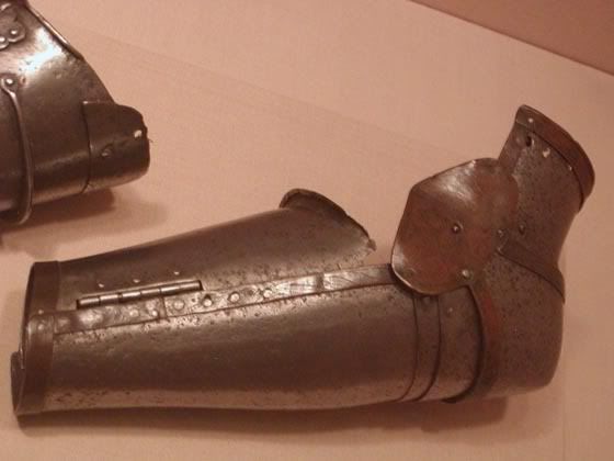

The wing is extremely similar to that on the leg harness RA III.1285 and 1286 in the Royal Armouries, Leeds. The date of thes legs have fluctuated quite a bit depending on who you ask. Boccia, Rossi and Morin dated them the end of the 14th century in Armi e Armature Lombarde. In L'Arte dell' Armatura in Italia, Boccia and Coelho date them to 1400-1415. The Royal Armouries currently lists them at circa 1420 in their inventory.
Just food for thought.
Posted: Sun Mar 09, 2008 4:36 pm
by Andrew Young
Rolling buckle alert....rolling buckle alert! (and its iron). :D
....but is it original???
Posted: Sun Mar 09, 2008 5:38 pm
by Talbot
Durasteel Corporation wrote:Rolling buckle alert....rolling buckle alert! (and its iron). :D
It could be but the arm is begining to suggest that it may be composite. Who knows where the buckle came from if the arm is composite.
Posted: Sun Mar 09, 2008 5:51 pm
by Talbot
Talbot wrote:Excellent! Now we're digging into this piece. This feature still appears in the 15th but it could push the date back a few years earlier. What is going on with the main vambrace plate and the buckle? It looks like the buckle is attached to the outside. If so we, probably have composite pieces. Do you have any pics that show this buckle more clearly?
Well I was wrong about the buckle. I went back and looked through my pics. The buckle is also properly done through a slot. I still beleive it is from around 1420 but it could be a touch earlier.
Posted: Sun Mar 09, 2008 8:52 pm
by Gaston de Clermont
Dr. Strong's dead on here, there's a steel loop around the buckle attaching it to the vambrace. If it were a roller buckle the roller would be on the other side of the buckle's frame.
The buckle in the crook of the elbow is attached to the cop by a leather strap, and there are two attachment holes in line with the strap on the wing of the cop. Only one of the holes is currently used for the strap. This might indicate that there was another buckle attached in a similar way to the one on the vambrace and it was repalced with the present setup. It's a little wierd if it was on the wing side, since Churburg #13 has the buckle on the opposite side.
As to the inner elbow lame being salvaged form elsewhere, it's certainly possible. It would also have had to be cut to size, and given some fairly subtle compound curves and slot articulation. It seems there's been an acusation of a crime, but no clear evidence of one, and no obvious motive, as adding such an anomoly only makes the piece more suspicious. Occam's razor doesn't appear to be on the side of fabrication here. Don't get me wrong, it's healthy to consider, compare and be suspicious of what we see, but let's build a case on some concrete facts before we cast accusations.
I'm sorry for what Brashford Dean had done to some of the psyche's here, but despite his transgressions it's quite possible that not all curators are armour molesters. :wink:

Posted: Sun Mar 09, 2008 10:59 pm
by Brian W. Rainey
Clermont wrote:As to the inner elbow lame being salvaged form elsewhere, it's certainly possible. It would also have had to be cut to size, and given some fairly subtle compound curves and slot articulation. It seems there's been an acusation of a crime, but no clear evidence of one, and no obvious motive, as adding such an anomoly only makes the piece more suspicious. Occam's razor doesn't appear to be on the side of fabrication here. Don't get me wrong, it's healthy to consider, compare and be suspicious of what we see, but let's build a case on some concrete facts before we cast accusations.
Observation of fit, function based on photographic evidence at hand. Not reconstructionist conspiracy theory. Maybe I should start a religion, though... Deanism.
The rest of the forearm cannon appears to be well made. and fits together quite well. The lame, not so much. Either in its extended or compressed state.
Facts, accusations of a crime? Nope, simple observation. If we had facts about this piece we would not be having this discussion. Correct?

Notice the hinges on the Musee de L'Armee arm are almost exactly the same as the copless vambrace next to the red velvet suit in the Met? That vambrace gets dated to 1420, so it bolsters Doug's assertion of a later date, assuming we can trust the dating and composition in the Met.

The abovementioned lower cannon at the Met has a significant flange protecting the elbow pit, and it's possible that in this case, an earlier 14th century vambrace with a clean-cut edge was modified with this add-on piece to provide the same defense. If that was the intent, it need not have been intended as a functioning mechanical lame, only a deflector of sorts. I'll go look for a postable picture of the Met cannon for comparison.
Posted: Mon Mar 10, 2008 1:42 pm
by Klaus the Red
Yep, it's on both of them (the complete arm possibly being earlier?) It should be noted that these arms, coming from the military outpost at Chalcis, are more likely to represent field armor and not tournament armor.
Posted: Mon Mar 10, 2008 2:20 pm
by James Arlen Gillaspie
Hmm... I was bothered by how poorly the rolled edges on the lips of the cuff of the Paris arm lined up, having just looked at the ones Klaus posted from the Met. Perhaps unnecessarily bothered. Still, the pic of the strap side of the cuff doesn't show how off the lineup is. I could swear I have a pic somewhere...

The Churburg #13 arms have a roll at the inner elbow that's not closed- it's not as exaggerated as the ones in the Met. One of them is cracked. With thin metal it's a bit of a tricky roll since you're stretching the metal so much. Using a separate lame keeps you from screwing up all the harder shaping you've done in the vambrace. So the extra lame is kind of a short cut for similar coverage.

Forget what I said about the hinges on the Paris arm. Even if the 'door' had been inset enough to cover up the cut out bit for an internal hinge, there should be tell-tale rivet holes (filled or not) to show where it had been attached. Clearly external hinges are correct.
Posted: Mon Mar 10, 2008 9:19 pm
by Klaus the Red
I was thinking that as well. This could potentially be a transitional form- 14th-century-style strap insertions, 15th-century-style hinges. If hinges, buckles and other closure items fell under the purview of different associated guilds, perhaps this arm was hinged by a shop that was more in touch with the cutting edge of armor fashion, as it were.
Posted: Mon Mar 10, 2008 10:08 pm
by Talbot

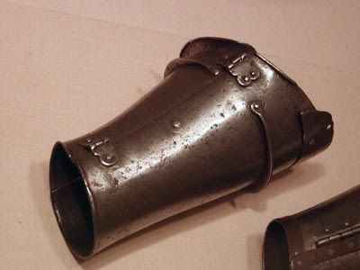

The met has a vambrace with these features. 29.150.22 has externally applied hinges and slots for straps. It is dated to 1425-1450.
By 1430 the slots are falling out of fashion and are being replaced with straps that wrap quite a ways around the vambrace. The same is true for greaves.
Posted: Mon Mar 10, 2008 10:12 pm
by Talbot
Correction-- the met has at least two of that same configuration. 29.150.33 is also set up that way. 29.150.19 may be. I have never seen the inside but there is a rivet on the outside (for the later setup) though Granscay did an excellent drawing of it and it shows this setup. It is possible that is wwas retrofitted with the more fashionable later strap style.
All are from Chalcis and carry the date 1425-1450

Why do you think this preference for strapping technique changed, other than simply a vagary of fashion? One would think a strap secured on the inside of the plate defense would be better protected than one on the outside. Perhaps with the increased used of heat-treating for high-end harness, the slots cut through the metal for the straps to emerge became weak points subject to stress cracks. The same might also hold true for cutouts made for in-line or integral hinges; it might have been easier to heat-treat and temper a piece without having to worry about the delicate fiddly bits of a hinge barrel, and then add more robust external hinges afterwards.
Posted: Mon Mar 10, 2008 10:17 pm
by Talbot
I'm not sure. It seems like a weaker setup to me though it might be easier to put on and take off. I'd love to hear input from one of our 15th century gurus. This is out of my depth. I have studied these vambraces in depth because Granscay initially dated them to circa 1400. Now though much scholarship on the part of the Met they have moved the date quite a bit later.

21.150.91G (the brass-trimmed arm) is still pretty firmly in the 1390-1400 camp stylistically, right?
Posted: Mon Mar 10, 2008 10:26 pm
by Talbot
Double post :x
Posted: Mon Mar 10, 2008 10:27 pm
by Talbot
It has all the earmarks of a late 14th century Italian arm. It has a smallish wing, inset hinges, slotted straps, tulip shaping on the vambrace, Three lames (2 down, 1 up), and the lowest lame is for rotation. It is possible that the arm could date to the very early part of the 15th century but there is nothing specific to suggest that it does.
It is worth noting that many of the above features continue into the 15th century. The inset hinges are the biggest defining feature for earlier rather than later though even these stay around until the second decade.
Posted: Mon Mar 10, 2008 10:28 pm
by Talbot
Klaus the Red wrote:21.150.91G (the brass-trimmed arm) is still pretty firmly in the 1390-1400 camp stylistically, right?
The capped wing is its biggest anomaly.

Is it capped, or straight latten? I don't recall seeing an additional thickness of a steel layer underneath when I looked at it last, but it's hard to see all of what's going on from that angle. Besides, don't you see lots of knees and elbows depicted as gold-colored metal in ms. both before and after 1400?
Posted: Tue Mar 11, 2008 7:56 am
Sure- So you've got a little challenge: to find a way to protect the crook of the arm. You can either flare the top of the vambrace and curl it over, which thins the metal, or add a little lame on, which doesn't thin it. If you've spent a few hours shaping the vambrace you might want to avoid any risk of cracking it by adding the lame instead of doing the roll? Does that make sense?
