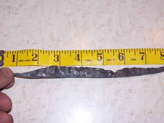

my first attempt at raising,don't laugh
Posted: Mon Nov 10, 2008 12:37 am
by sha-ul

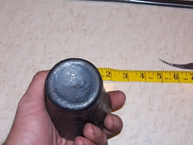

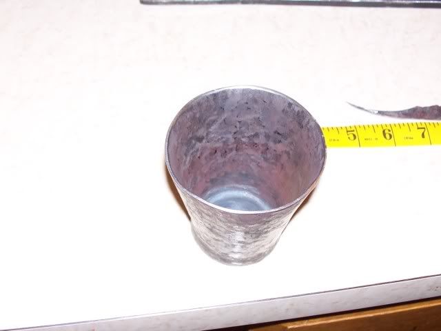

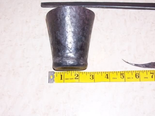

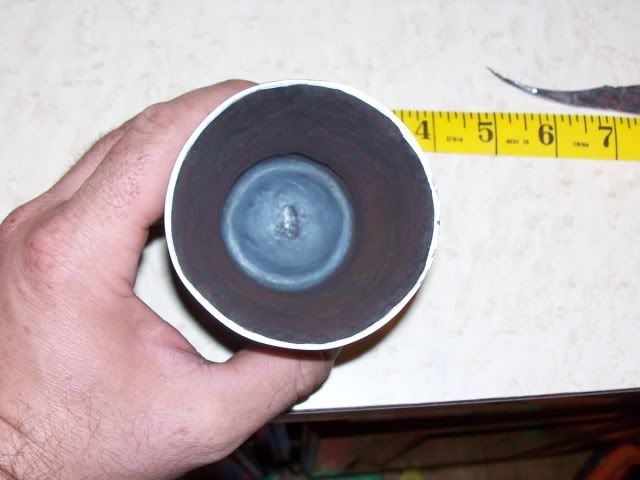

well at least my 1st attempt that went past the "saucer" stage (those were aluminum)
I used the bottom of an old coffee can as the pattern, started raising on a 2"ball, and took to completion on my 2" round stock T stake
you can see some of the inconsistencies in the thickness & roundness of the vessel
I had to trim this much off to make an uniform edge, which I deburred& sanded smooth, so far that is the extent of the finish work
btw I thought I had cut the disk from 16ga, but I think now it might be 14ga ...that was the thinnest on the rim

Sha- ul,
That looks OK!
Make another one or two in copper, and you will be ready to do it in silver.
Posted: Mon Nov 10, 2008 9:23 am
by sha-ul
Mac wrote:Sha- ul,
That looks OK!
the only copper I have is ~22 ga....I have some 20 ga brass, but I suppose this is too thin.
What do you recommend thickness wise?
Posted: Mon Nov 10, 2008 9:43 am
by Mac
sha-ul,
Thin material is miserable to raise.
I would recommend at least 18ga.; 16 would probably be better yet, (the gauge used for non-ferrous metals is "thinner" than the one for steel).
If you are going to use brass, you will want the one called "cartridge brass" or "drawing brass". This is 70% Cu, 30% Zn. It is alloy #260. If you bought it "dead soft" it would save you an annealing, but "half hard" cuts better, if you are using a snips.

Posted: Tue Nov 11, 2008 3:03 pm
by RalphS
You probably did cut it from 16ga. Material can thicken when raising. In time, you'll learn how to use that to your advantage.
Looks great for a first attempt by the way!

Posted: Tue Nov 11, 2008 9:29 pm
by sha-ul
Mac wrote:Sha- ul,
That looks OK!
I called on some sheet brass, they had 14& 18. for the 14ga, a piece 12"X12" was $55 :shock:
I have some 18& 16 ga stainless though....
what thicknesses have you found conducive to raising?
